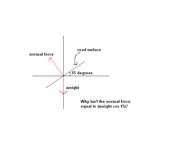

If a car is going up or down an inclined plane, the normal force on the car is just mg cos (theta).
However, if a car is turning on an inclined curve, the normal force is mg/cos(theta). Why are the two normal forces not the same?
To clarify, here is an example problem:
A highway curve of radius 70m is banked at a 15 degree angle. At what speed can a car take this curve without assistance from friction?
I've attached a force diagram of the problem.
Thanks for the help!

Consider the car's acceleration. In one case, the acceleration has no component normal to the surface, but in the other case, it does.
To find the normal force, one must apply Newton's 2nd law. Start by identifying all the forces acting on the car and the car's acceleration.

I'm sorry, but I'm still confused. How does that explain why the two cars have different normal forces (the only difference being that turning car has centripetal acceleration)?
First tell me how you know that the normal force on the car going up or down an inclined plane is mg cos (theta). (You have to figure it out using Newton's 2nd law!)

I thought that the normal force, in this case, is the force of the ground against the car. This is why I have the normal force vector pointing toward the car.
And yes, I also think the normal force is weight cos(theta). However, the book I have states that the normal force is weight/cos(theta). Why is there a discrepancy?

The arrow is drawn correctly. The road most certainly does push up on the car!
As to why the normal force isn't weight*cos(theta), I can't answer that- because it is!
That's only true when the acceleration is parallel to the road surface (or zero).
When the car's going around a curve you have centripetal acceleration to contend with. The steeper the angle, the faster you have to go to keep from sliding down. The faster you go, the greater normal force needed to provide that centripetal acceleration.

Here's what your reasoning should be: Since the car does not accelerate in a direction perpendicular to the plane, the net force in that direction must be zero. From that you can conclude that normal force = mg cos(theta).
But that's not the case when the car is going around a corner. In that case there is a component of acceleration perpendicular to the plane. For that problem, you want to realize that the vertical component of acceleration must be zero, while the horizontal component must equal the centripetal acceleration.

The first part of your logic makes perfect sense. However, I'm still not clear on the second part. What is the component of acceleration perpendicular to the plane? If there is a net acceleration perpendicular to the plane, shouldn't the car be being lifted into the air? Thanks.
Ultimately, here is the discrepancy I'm confused about. I've attached the image.

You realize that if the car is turning a corner it is undergoing circular motion. And that something moving in a circle is accelerating towards the center. Correct? (If not, review circular motion and centripetal acceleration pronto.)
The car accelerates toward the center of the circle it is turning on. That acceleration is horizontal and has a component perpendicular (and parallel) to the plane.
No. The vertical acceleration is zero. But realize the car is accelerating.
Understand circular acceleration. For example: Twirl a ball tied to a string in a circle. The ball has an acceleration towards the center, yet it doesn't move towards the center.
Note that the net acceleration is horizontal. But there is a component of acceleration perpendicular to the plane.
Your diagram shows the forces on the car (weight and normal force) but doesn't show the acceleration of the car. You need the acceleration to figure out the normal force (if you want to know it). The acceleration--a centripetal acceleration--will be a horizontal vector pointing to the left in your diagram.

Thank you for your patience! I now see the perpendicular component and can solve the problem. I'm teaching myself physics right now, and good help is hard to come by. Again, I really appreciate it.
