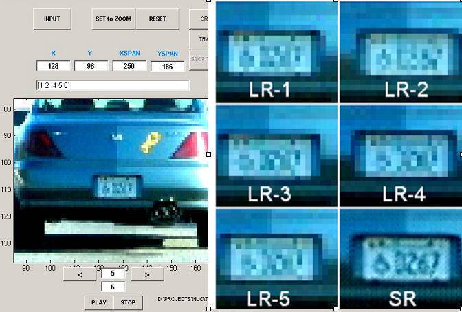

I have several images of a California license plate (blue letters on white background) that were taken by a security camera here at my work. We need to contact the driver of the vehicle, so I am trying to apply some processing to the images to see if I can make out the license plate number.
I did some googling, and found that the process of combining multiple noisy images to get better clarity is called "Super Resolution Reconstruction". Does anybody here on PF have experience with this kind of image processing? Is there a different approach that I could also try? I downloaded a free image processing program called ALE, which is supposed to include SR capability, but I haven't had time to figure it out yet.
There are 5 base images of the plate, and one PhotoShop enhanced image of the best plate image. I've attached three images to this post, and I'll post the other three in the next post. Thanks for any help or ideas you folks have.

I suggest looking into track-and-stack image processing programs. These are commonly used for tasks like webcam astronomy, which produces a succession of low-resolution images. You can align and add the images (hence the name track and stack) to improve SNR and perhaps see more detail that on any single image alone.
You can do the same work with a tool like Photoshop, as well -- blow the images up, artificially increasing their resolution, then align and add them together.

I'm trying to do some track-and-stack like work in Photoshop, but it's not revealing much. I really think the SNR of all but the first couple of images is so bad that they're not worth using. Unfortunately, you only have a couple of the better-SNR images. If you had perhaps 10 or so frames of that quality, this would probably be tractable. Do you have any additional images at all?
- Warren
Unfortunately no. The security camera presently only shoots 2 frames per second, and has mediocre resolution. Hopefully that will be upgraded in the near future. Thanks for trying, Warren. -Mike-

Super-Resolution License Plate
I applied super-resolution techniques to your images but the result was not good. Probably they don't contain enough information when combined to produce a higher resolution image. See attached image for an example of 5 low-res license plate images (LR) and producing a good super-resolution (SR) result.

Thanks for tryin, mmccorma, and welcome to the PF. What software did you use?
No problem. I wrote the software and a GUI for super-resolution in Matlab. It finds the integer and then sub-pixel offsets among a set of images using the Taylor series method described in this paper: http://www.ph.tn.tudelft.nl/~lucas/publications/2000/SPIE2000CLLV/SPIE2000CLLV.pdf
Finding the correct sub-pixel offsets is the key to resolving a higher resolution image. Then it's just a matter of interpolating a non-uniform grid of pixels to a uniform and denser grid.
--Mike

from mike's post I read _D267
with the _ looking like the handycapped tag wheelchair grafic
