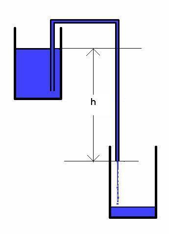

second qn, a syphon
y the pressure at upper part can be neglected?
then, the mass at the upper reservoir is so much bigger than the column of water which go down to lower reservoir, y the water tend to go down thru the column of water which go down to the lower reservoir?

wat i interest to kno is the "h" onli, y it onli nid to draw til the surface of water but not the whole column of liquid?

It is not clear to me what your question is regarding your second problem. Do you not understand how a siphon work?

second qn is...emm wel i understand tat the column of water outside the reservoir is longer hence gravity force pull down there and create and partial vacumn which cause the liquid in reservoir to flow out, and the factors of cohesive force 2
but wat i cannot understand is y the effective pressure using the h in the diagram, the h onli up til the surface of water but not the whole column?

See this excellent site for an explanation of the working of a siphon:
http://www.pump-flo.com/company/pumpcenter/siphon.pdf"
i checked the site, it provide many explanation, but the sentence "the difference in height between point 2 and 6 provide the energy" wifout any explanation make me disappointed once again...i nid some numerical explanation, but i can't done it myself as i have tried for a long time, sigh
anyone can explain to me?...
