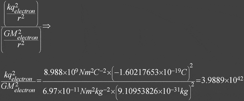

Calculate the ratio of the electrostatic force to the gravitational force between two electrons.
My effort:
[tex] \begin{array}{l}<br /> \frac{{\left( {\frac{{kq_{electron}^2 }}{{r^2 }}} \right)}}{{\left( {\frac{{GM_{electron}^2 }}{{r^2 }}} \right)}} \Rightarrow \\ <br /> \\ <br /> \frac{{kq_{electron}^2 }}{{GM_{electron}^2 }} = \frac{{8.988 \times 10^9 Nm^2 C^{ - 2} \times \left( { - 1.60217653 \times 10^{ - 19} C} \right)^2 }}{{6.97 \times 10^{ - 11} Nm^2 kg^{ - 2} \times \left( {9.10953826 \times 10^{ - 31} kg} \right)^2 }} = 3.9889 \times 10^{42} \\ <br /> \end{array}[/tex]
Sorry for small tex. This should be better:
My units cancel nicely, so I assume I did it right. However, the book doesn't give the formula I used: F=kqq/r^2

Close but your value for G is too high. G = 6.67x10^11 Nm^2/kg^2. I get 4.17x10^42
Your approach and method is correct.
AM
Thanks for catching that. I thought I had that memorized.
