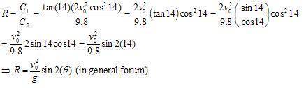

ok, so we have y=V_0sin14(x/(V_0cos14) - 1/2(-9.8)((x/(V_0cos14)^2. we can simplfy this equation by changing the V_0sin14(x/(V_0cos14) into V_0tan14(x) giving us y=V_0tan14(x) - (1/2(-9.8))/((V_0cos14)^2)(x^2)
in this case, V_0tan14 and (1/2(-9.8))/((V_0cos14)^2) are both constants, so for simplifcation let's say that:
V_0tan14=C1 and (1/2(-9.8))/((V_0cos14)^2)=C2
so now we have y=C1(x)-C2(x^2)
now, x is how far the object went in the x direction correct? so x can also be called the range
so, y=C1(R)-C2(R^2)
does this make since?
okay how does V_0sin14(x/V_0cos14) to V_0tan14(x)?
I see how you simplify it so the equation can be read easier but I am not really sure how i would solve y=C1(R)-C2(R^2)
ok, well V_0sin14(x/V_0cos14)=(V_0sin14(x)/V_0cos14)=(V_0sin14/V_0cos14)(x)=V_0tan14(x)
does that make since?
Oh okay I get it now. I see what you did now.
ok, so we have y=C1(R)-C2(R^2) where R is the range (or distance the object went in x direction). so, when does a projectial reach its max range?
what do you mean by max range? is it the distance that was given which is 12?
