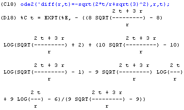

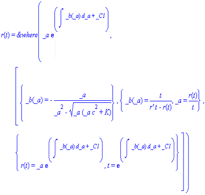

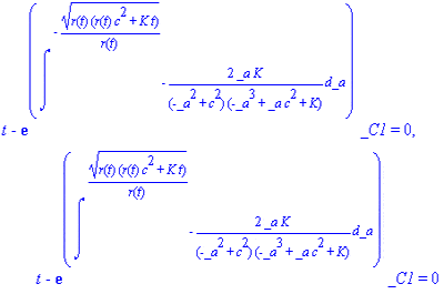

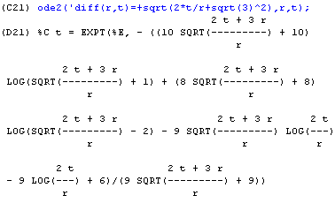

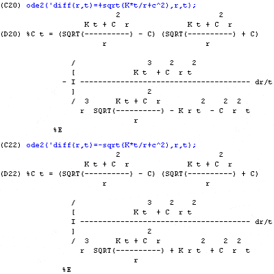

Differential Solution...
[tex]r(t) = \frac{Kt} { \left( \frac{dr}{dt} \right)^2 - c^2}[/tex]
[tex]\left( \frac{dr}{dt} \right)^2 - c^2 = \frac {K t}{r(t)}[/tex]
[tex]\left( \frac{dr}{dt} \right)^2 = \frac{Kt}{r(t)} + c^2[/tex]
[tex]\frac{dr}{dt} = \sqrt{ c^2 + \frac{Kt}{r(t)}}[/tex]
[tex]dr = \int \sqrt{ c^2 + \frac{Kt}{r(t)}} dt[/tex]
differential solution:
[tex]r(t) = t \sqrt{ c^2 + \frac{Kt}{r(t)}} + C[/tex]
[/color]
no other known solutions exist.
[/color]

Hi, everybody;
My Maple 9 gave me 3 different solutions (obviously they are connected to each other) for the original equation. Here they are. I think, everything is clear. I beleive, the integrals can be evaluated under some conditions for K and c, e.g.: K=3, c=2, or K=c^2 or K=3*c (all of them are just the examples, not the real conditions leading to explicit solutions for r(t) or t(r)).
Best of luck,
Max.

solutions from Maxima
Hi again;
Maxima gives us the following solutions: MaxSol1and2.gif.
I think that the simplest variants of solutions are those for K=2 and c=sqrt(3)=3^(1/2) (I assume that K>0 and c>0): MaxSol3.gif and MaxSol4.gif.
Good luck,
Max.
P.S. Use Maxima http://maxima.sourceforge.net/download.shtml - it's free, open source and effective for the problems like this one.
