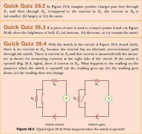

Question 1 (comes directly from a picture attached):
A potential difference is setup between two points, perhaps the terminals in a battery, and this causes charges to move. However, the potential difference is of course created by an electric field.
Right?
Every potential difference, or voltage, MUST be created by some electric field.
Now the electric field of course produces forces on the charges, which in turn causes them to move, creating a current. Shouldn't the electric field be weakening as the inverse square of distance?
Why then is the electric field taken to be constant?
Current is how much charge per unit time is passing through a certain point, so the current should be different at every single point since the force which moves the current is different at every point and the mass of the charge of course doesn't change.
So why is it said that the current will be the same through every point in a resistor in series combination?
This question originates from the picture I have attached...Quick Quiz 28.2...I thought the answer would be a) smaller...but apparently the answer is the same.
Why would the charges still be moving at the same speed when not only should the field be changing, but their potential has dropped.
If anybody could explain the error in my thinking here, I'd be very thankful.

Then how in the world, in Quiz 28.4 (above pic attached), does the current in the closed switch scenario not even go through R2?

No work is required to move an electron on a metalllic surface. So if you apply a potential to a circuit the electrons drift through the wires without any energy expenditure. I interpret this to mean that the electic field is zero in the wires - no charge buildup is sustained. Therefore (virtually) no work is done by the battery to move the electrons through the wires. This strange phenomena is demonstrated in superconducting materials (with virtually no resistance watsoever). Once the current in a super conductor is started with a power supply it can be disconnected from it and the current will continue flowing indefinitely.
Current flow behaves very much like water flow - you cannot cause a localized flow without causing all of the electrons to move (drift) in the circuit. It behaves like water in a pipe - all or nothing moves in unison.
For QQ 28.2 the diagram on the right with the switch open should be considered. That is in a series circuit the current is the same through all of the components. The electrons push each other to drift at the same speed through all of the circuit from the low potential to the high potential terminal. Any pileup (large resistor, capacitor) will impede the flow through the whole of the circuit.
You need to remember that each electron communicates its motion to its neightbours (via its electric field) and in this way the flow of current in a circuit tends to acts as a unit being driven by the power supply. You should not think of single cars moving but rather a stream of cars moving along the highway (the sea of free electrons in the material). If the lanes are reduced (higher resitance somewhere in the circuit) the flow of traffic will be reduced all the way down along the highway.
