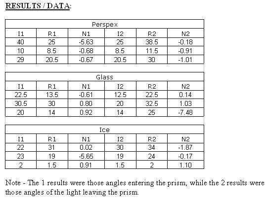

Hi
I have just conducted the experimental stage of a practical 'to find the refractive index of different objects using Snell’s law' (which states sine i/sine r =N). The objects chosen were Ice, Glass, and Perspex. As 3 trials were taken for all 3 objects, if these points were graphed, and a line of best fit was applied, I believe the gradient of this line would be the refractive index? Is this correct? Also does the I and R angles of the light leaving the prism hold any significance?
attached are my results.
RESULTS / DATA:
Perspex
I1 R1 N1 I2 R2 N2
40 25 -5.63 25 38.5 -0.18
10 8.5 -0.68 8.5 11.5 -0.91
29 20.5 -0.67 20.5 30 -1.01
Glass
I1 R1 N1 I2 R2 N2
22.5 13.5 -0.61 12.5 22.5 0.14
30.5 30 0.80 20 32.5 1.03
20 14 0.92 14 25 -7.48
Ice
I1 R1 N1 I2 R2 N2
22 31 0.02 30 34 -1.87
23 19 -5.65 19 24 -0.17
2 1.5 0.91 1.5 2 1.10
Note - The 1 results were those angles entering the prism, while the 2 results were those angles of the light leaving the prism.
cheers
matt

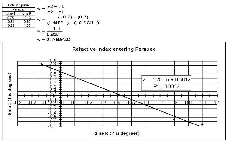

how I've been graphing so far
this is what I've done, is this correct? so if i take the gradient this shall be the refactive index?

hi i was wondering if you could please help me with the graphing of snell's law, as I've been told you can graph somthing over somthing and the gradient of this line is the refactive index, are you able to assist as I am quite confused as the current results i am getting are quite wrong!
cheers matt
Sorry my explanations are clear only to me. Let's try again.
Instead of labelling your data values as [tex]I_1\ and\ R_2[/tex] label them as [tex]\theta _a[/tex], that is these angles are the angles measured in air.
Change your labelling for the [tex]R_1\ and\ I_2[/tex] angles to [tex]\theta _p[/tex], that is these are the angles measured inside the material of the prisma.
Then plot a graph of [tex]\sin(\theta _a)[/tex] as a function of [tex]\sin(\theta _p)[/tex].
The gradient of such graph will be the index of refraction of the prisma material. Hope this makes it clearer.
