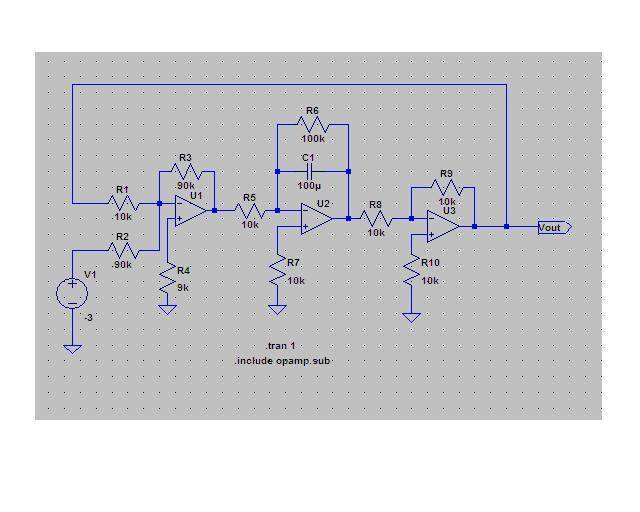

I am instructed to design an analog computer to solve the following equation using 2 summing amplifiers and a integrator. I have attached a image of what I've done. I am seeking confirmation of my circuit or hint as to how to proceed.
Thanks in advance!
eqn: x' + 9x = 3

Can you describe your circuit some for us? Why are you adding in 3V before doing the differentiation? What is the overall feedback for? Is V1 meant to be both x and the 3V offset?
As I understand the process: solve for the highest derivative, so
U1: x' = -(-9x + 3)
U2: -x = Integration of x'
U3: x = inversion of -x feedback to U1
This was my implementation, I have also included a link to a pdf file I was using as reference [http://dcoward.best.vwh.net/analog/Aug00S&V.pdf]
