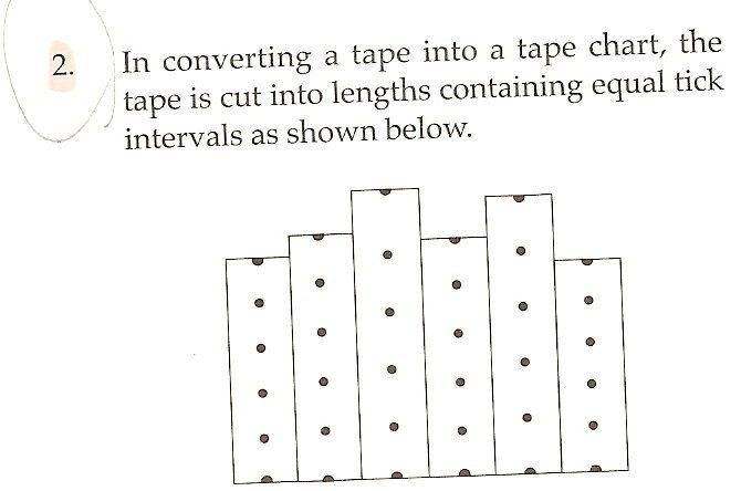

Refer to the uploaded file,
Which of the following statements is/are correct?
(1) The length of each tape represents the average velocity within the time interval.
(2) The width of the tape represents the constant time interval.
(3) Joining the centres of the tops of the tape gives a displacement-time graph.
A (2) only
B (3) only
C (1) and (2) only
D (1) and (3) only
The answer is C.
But I don't understand why (1) is true.
Try uploading your image to imageshack.us, then post the link, since it may take a while for the attachment to be approved.
speed=distance/time
time=5 ticks=constant (for each column)
distance=length of column
so, if speed=avg velociy
avg velocity=length of column*constant
(note:constant=1/time)
or more simply: avg velocity is proportional to length of column
