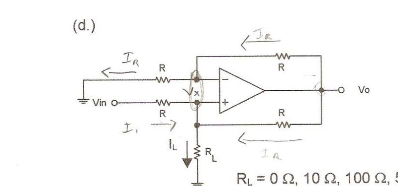

here's a new one giving me trouble: Find an equation for [tex]I_L[/tex] in terms of [tex]V_I[/tex] [tex]R[/tex] & [tex]R_L[/tex]. there's an additional problem asking what [tex]I_L[/tex] is when [tex]R_L[/tex] is different numbers.
I started with a KVL around the loop Vi to ground:
[tex]-V_i + I_1*R + I_L*R_L = 0[/tex]
solving for [tex]I_1[/tex]
[tex]I_1 = \frac{V_i - I_L*R_L}{R}[/tex]
Next is a KVL starting from ground near the negative terminal, and wrapping my way around to the other ground:
[tex]-I_R*R - I_R*R + I_R*R +I_L*R_L = 0[/tex]
solving for [tex]I_R[/tex]
[tex]I_R = \frac{I_L*R_L}{R}[/tex]
now for a KCL at point [tex]V_X[/tex]
[tex]I_1 + I_R = I_L[/tex]
Now I plug my other equations into this equation and solve for [tex]I_L[/tex]
[tex]I_L = \frac{V_i}{R}[/tex]
I don't think this is right because the next part of this problem is to plug in different values for [tex]R_L[/tex] and solve for IL (Vi and R are given), but this equation says [tex]R_L[/tex] doesn't make a difference.
Maybe use KCL to check your answer. I never liked KVL anyway. The KCL is so much more intuitive for me, and I find it is less prone to omission mistakes.
alright here goes with non-stop KCL:
(+ terminal)
[tex]\frac{V_i-V_X}{R} + I_R = \frac{V_X}{R_L}[/tex]
(Vo terminal)
[tex]\frac{V_O - V_X}{R} + \frac{V_O - V_X}{R} = 2*I_R[/tex]
(- terminal)
[tex]\frac{V_X}{R} = \frac{V_O - V_X}{R}[/tex]
solving this one for [tex]V_O[/tex]
[tex]2*V_X = V_O[/tex]
stick this in (Vo terminal) equation, solve for [tex]I_R[/tex]:
[tex]I_R = \frac{V_X}{R}[/tex]
slam this back into first equation, solve for [tex]V_X[/tex]
[tex]V_X = \frac{R_L * V_i}{R}[/tex]
put this into a [tex]I_L = \frac{V_X}{R_L}[/tex] equation and BOOM:
another [tex]I_L = \frac{V_i}{R}[/tex] ...Well this worksheet is dumb for asking me to plug in different values for [tex]R_L[/tex]
Get the same answer with two different approaches, and you can feel good about your answer, right? And I'll bet you're starting to like the KCL better about now, right?
