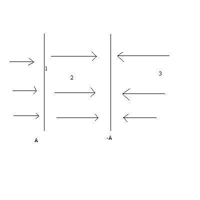

The solution is supposed to be zero, but I'm not sure why. It seems that there should be some electric field to the right of the plates due only to the negatively charged plate. Taking the Gaussian approach and enclosing them in a sphere seems to suggest that there is no net electric charge outside the two plates, because the charges are equal and opposite, but I'm not sure. Would someone care to give me another point of view?

Sparkimus,
In your drawing, it looks like you are only showing the field due to the negative plate. What about the positive plate?
I think that when you draw the field of the positive plate, you will see that in between the plates the field is heading in the same direction, and so they add. On either sides, the fields are opposite, and so will cancel.
Part a) of the question asked for the field to the left of the positive plate. Did you get that one correct, and understand why? If so, the answer is the same for the field to the right of the negative plate, and for the same reason.

I was thinking in straight lines, excuse me. From my understanding the negative plate would not put forth an electric field, it only receives electric field "lines." But from what you said I think I have an inkling of what you mean. You're saying that the electric field from both plates expands outward through spaces like ripples in a pond. One splash in the (hypothetical) pond would produce concentric waves expanding outward, losing intensity the farther they move from the center of the splash. While two such splashes would add disturbance in the middle and interfere with each other around the edges. Is that correct?
I wish I had a scanner or a tablet, expressing my ideas in solely in words is frustrating.
No I didn't get this one right, I misinterpreted the question, but with this insight I'll redo it.

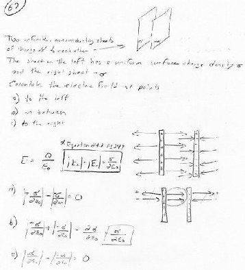

Spark,
You are correct about the negative plate accepting field lines.
And the positive plate sends out field lines.
See my attachment. I have the next edition (6th?) of the same book, so my note on which problem number and pg for equation etc is a little different.
Take a look at the diagram I drew, with field lines from the positive and to the negative plates. This should help you to "see" the cancellation on each side of the plates. Notice in the middle the fields are heading in the same direction, that is why they add.
Let me know if this helps.
Here is the attachment...I hope it is readable. I had to scan it about 4 times at lower resolutions and then make it smaller the 400x400.
