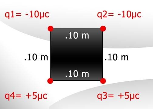

Problem 55)
What would be the magnitude and the direction of a vertical electric field that would just support the weight of a proton on the surface of the Earth? of an Electron?
and lastly,
Problem 61)
What is the electric field at the center of the sqaure in the following figure:
For problem 36, you do need to use the equation listed to figure out the force on the electron for part a. Once you have the force, how can you relate that to the electrons speed and acceleration?
