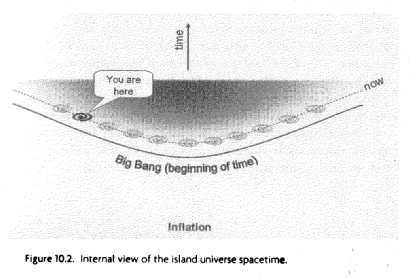

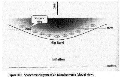

Finite or infinite universe?
Can someone help me please, Alex Vilenkin in his book Many Worlds in One, proposed the spacetime structure where the Universe can be finite as seen from “outside” but infinite when seen from inside – from our point of view.
How is it possible that universe can be infinite and finite… I don’t want to say at the same time, but somehow from different perspective?
