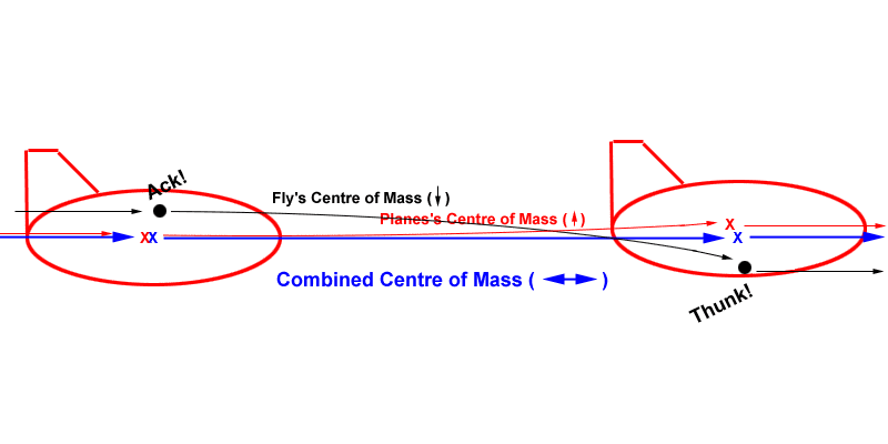

P.S. If the fly were dead and suspended above an AC unit, yes it wouold still add to the weight. The fly's weight pushes down on the air, which pushes on the AC unit, which pushes on the plane.
Consider scaling it up to an elephant over a very powerful AC unit in a 747. It becomes pretty intuitive that a plane with an elephant in it is heavier than a plane sans elephant. In fact, you don't even need the plane to fly. It weighs more on the ground. In fact, you don't even need the plane...
If the fly suddenly dies in mid air, and then fall to the ground, then the weight would not contribute to the plane before it hit the ground.
The potential energy that contributes to the weight of the plane transform into kinetic energy on the way down, and then transforms into potential energy on impact. Isn't that right?
In an air conditioner, the air molecules constantly have to push the fly UP, pushing them DOWN, making the fly contributing to the weight of the plane. On a free fall, the fly's weight is not supported, so the weight should not be contributing to the total weight.

As the fly falls to the ground, it is pushing air downwards, this air pushes on the plane's floor. There is no escaping the fact that the fly contributes to the plane's weight. Try as you may, but like a fly in a jar, there is no escape.
If but when the fly is falling, the air that is pushed down is minimal, the only force the plane gets is the the force the air resists the falling fly with. Because the fly is dropping in height, means that there is no force to keep it up, making the plane not contributing to it's weight. I agree with you if the fly was flying around, but not if it is falling.
Jarle said:
If but when the fly is falling, the air that is pushed down is minimal*, the only force the plane gets is the the force the air resists the falling fly with**. Because the fly is dropping in height, means that there is no force to keep it up, making the plane not contributing to it's weight. I agree with you if the fly was flying around, but not if it is falling.
* and by "minimal", you mean "equal to the weight of a fly"
** and by "the force of air resistance", you mean "equal to the weight of a fly"
They are small, but they are measurable.
Now, as far as a falling object - see attached illo.
For the duration of the fall, it is true, a falling fly would not contribute to the weight of the plane. What would actually happen is that the plane as a closed system would have its centre of mass remain in level horizontal motion. As the fly fell, the plane would rise slightly (very slightly).
However, when the fly hit bottom, the plane would stop rising. If you could measure the trajectory of the plane before and after the death of the fly, you would measure it very, very slightly higher (though still traveling horizontally). You would also note, contrarily, that the centre of mass of the airplane-AND-fly-system would NOT have changed in altitude.
BTW, this actually happens when bombers drop bombs or firefighters drop water; the plane will shoot skyward and the pilot has to fight to keep it level. It doesn't matter whether the cargo is internal or external.
:smile: This was what I meant. I also mentioned that that when the fly hit the plain floor, the weight of the fly would again contribute to the plains weight.
