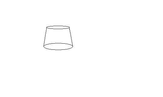

Like Hurkyl says, why not just work out the volume of all the shapes from bottom to top?
https://www.physicsforums.com/attachment.php?attachmentid=9189&stc=1&d=1171719342
so what you mean here I just find the linear function from 0-120 and then just take the integral of it from 0 to 120 phi*(the linear function)^2 dx
A "quick and dirty" way to do this would be to treat the radius as being a constant from each level up to the next, find the volume of each cylinder and add.
If you use a "piecewise linear" function to be more accurate, then you could do each one as a truncated cone.

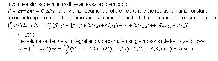

I think on this specific problem you just have to use Simpson's rule in order to approximate the integral. V=2πrh for any small part of the tree considering the radius remains constant. in order to get the approximate volume you use any of the numerical methods of integration such as Simpson's rule of trapezoid rule.
thanks Bruk, that really clears up the problem and probably the shortest way to do it
