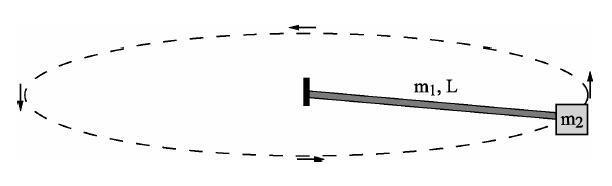

A block of mass m2 is attached to a cord of mass m1 and length L, which is fixed at one end. (Note, not a massless cord!) The block moves in a horizontal circle on a frictionless table. If the period of the circular motion is P, find the tension in the cord as a functions of radial position along the cord, 0 <_ r <_ L. (<_ meaning greater than or equal to)
a = v^2/r, F = ma
So I could immediately tell that this problem involves setting up an integral equation of some sort. I've learned in class how to solve for integral equations when a block is hanging on a ceiling or things as simple as that, but none of these.
So if L is the distance from the center of the circle to some arbitrary point on the cord, I think the tension at the very end of the cord connected to the mass will just be the centripetal acceleration of the mass multiplied by m1, so there's one of the limits of the integral equation. The other limits should be 0 and L for the radius. The last one will be the unknown for which I have to solve for.
But when I set up my equation and solved for it, I somehow got T(L) = m_1*2*pi*L + T(0), which doesn't make sense.
Why? Does the mass of the block disappear? For any point on the string at a distance x, if you assume the linear mass density to be [tex]\lambda =\frac{m_1}{L}[/tex] then the string at that point is [tex]\lambda xdx+ m_2[/tex]. Figure out the variation of x and then integrate.
oops i meant m2. but anyway i'll try to carry it out with your advice
