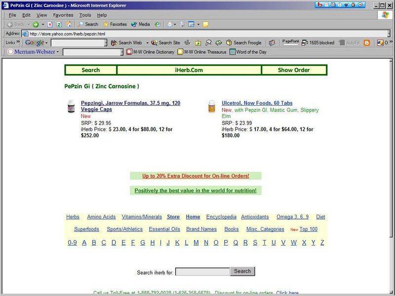

Your link to the yahoo! store doesn't work.
It doesn't show this?:
