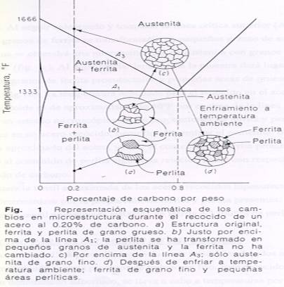

Annealed 1018 Steel - Investigating Darker Regions

Hi, steel 1018 usually has between 0.15-0.20 % of Carbone, yes, the darker regions are perlite
Sure, dark structure is Perlite.
Carbon fraction is given in alloy specification
1018 [tex]\rightarrow[/tex] 0.18% Carbon
And ... Annealing Treatment ( Total Annealing) may result in perlite + ferrite.
It's shown in your micrograph
Dark - perlite
Bright - Ferrite
