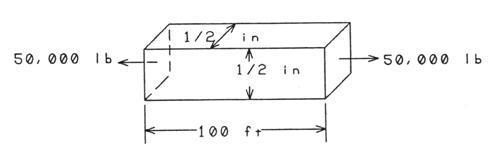

Longitudinal elongation
Hi. I am hoping someone can be of assistance in helping me solve a problem.
I am trying to calculate the longitudinal elongation of the steel bar shown in the attachment. I don't know where to start, so if anyone could point me in the right direction such as which formula I should use I would really appreciate it. |

I think the fomula needed to find elongation is: Axial tension strain equals change in length divided by original length I know that the original length is 100 ft, but I still need to find the stain in order to complete the problem. I think this requires using the modules of elasticity formula to find the stain Modulus of elasticity equals stress divided by stain I know the modulus of elasticity of steel is 30,000,000 psi, but I do not know the stress. I think stress can be found by dividing the load (50,000 lb) by the area (2400 sq in). When I work this out it doesn't come out right. I know the answer to this problem is 8in. I've even tried working it backwards, but I am either missing a step or calculating something wrong. I would really like to understand the steps to work this problem. Thank you. |

Well I don't know how to guide you more here, so I'll just say it, but really try to think more of the physical problem rather than formulas next time. You force is acting on the cross-section of the beam, ONLY that area is needed to calculate the stress by: stress=force/area, then you use Hooke's law for elongation as you described and mind the units.

Thank you for your help. I think I am understanding now.
Stress=force/area therefore stress = 50,000/.25 so the stress is 200,000 psi then using Hooke's law.. strain equals stress divided by modulus of elasticity therefore strain equals 200,000/30,000,000 so strain is .0066667 then to find the amount of elongation.. Axial tension strain equals change in length divided by original length therefore .0066667 = x/1200in x=8 so the change in length is 8 in I know the answer is supposed to be 8 in, have I done the process correctly this time? |

Holy mackerel. 50 kips on a .5 in square piece of steel? Nice to see they're keeping the problems in the realm of reality.
How about just calculating the deflection directly? Does [tex]\delta = \frac{PL}{AE}[/tex] look familiar? |
