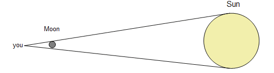

At a certain point in the Earth's orbit around the Sun, its distance from the sun is 92.69 x 10^6 miles. At this point the angle subtended by the sun when observed from the Earth is [Angle = 32' (arc minutes)][/color]
a) Considering the Earth's radius to be negligible and making any other reasonable simplifying assumptions, use the law of cosines to find the diameter of the sun giving your answer to the nearest 1000 miles.
b) using any assumptions and reasonable method, find the distance to the moon when its subtended angle is 32' arc minutes (0.54 degrees) assuming its diameter is 2160miles

Found this image on another site...This is same on my homework paper.

Well there are two approaches, at least, and in passing must mention what a curious situation we enjoy currently when the moon and the sun subtend the same angular size in the sky. It allows for a just so often total eclipse where the Earth falls into the shadow of the moon.
So you could solve this by similar triangles, that is the ratio of the suns diameter to the distance is the same as the moon to the earth. Or just use
tan(angle/2)=radius/distance.

Hey doc, How are ya? BTW if you note the diagram that katrina007 thoughtfully provided you will see that tan(angle/2)=radius/distance is subtly wrong. If the angle subtended is very large, it's very wrong. Funny, I hadn't thought of that. BTW also what's with this curious coincidence of the moon's angular size and the sun's? Anthropic? Sorry to the OP for disgressing on the post.

Both approaches work quite accurately. And neither approach works completely. The difference is the difference between drawing a vertical diameter through the sun and a vertical line between your two tangent points. The aren't quite the same, right? But for small angles the difference can be ignored.

Ok, the really correct answer is distance*sin(angle/2)=radius. Can you figure out why? Let's compare how this does vs various 'incorrect' answers (like the one doc and I were proposing and the 'law of cosines' (at least as I was interpreting it)). I'm using the .54 degree angle. 34' is a few percent different.
sin formula (correct): 862794.5830208
tan formula (incorrect): 862803.927896
'law of cosines' (incorrect): 862794.5830212
I guess the moral of the story is that nature is pretty forgiving of sloppiness for small angles.
