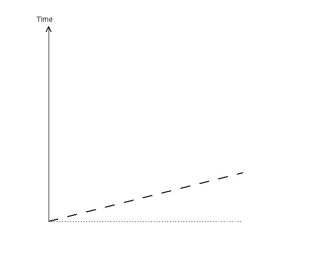

Simultaneous events are events that are assigned the same time coordinate, in some particular coordinate system.
Seen is ambiguous, but usually means the time assigned to the arrival of light.
The important point, which can't be stressed enough, is that the set of events regarded as simultaneous is one coordinate system is not simultaneous in another.
This can be drawn on a space-time diagram, for instance the dotted and dashed lines in the diagram below represent the set of events regarded as simultaneous by two different observers. Visual inspection shows that they are not the same set of points.
