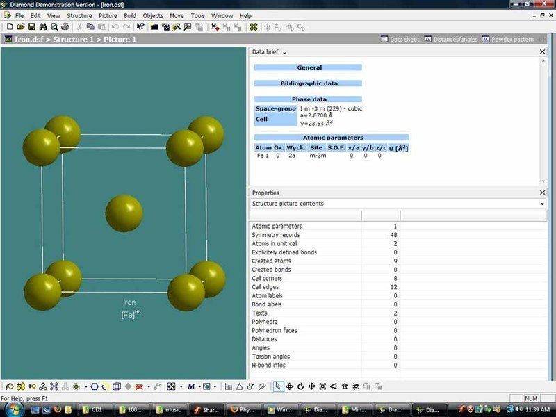

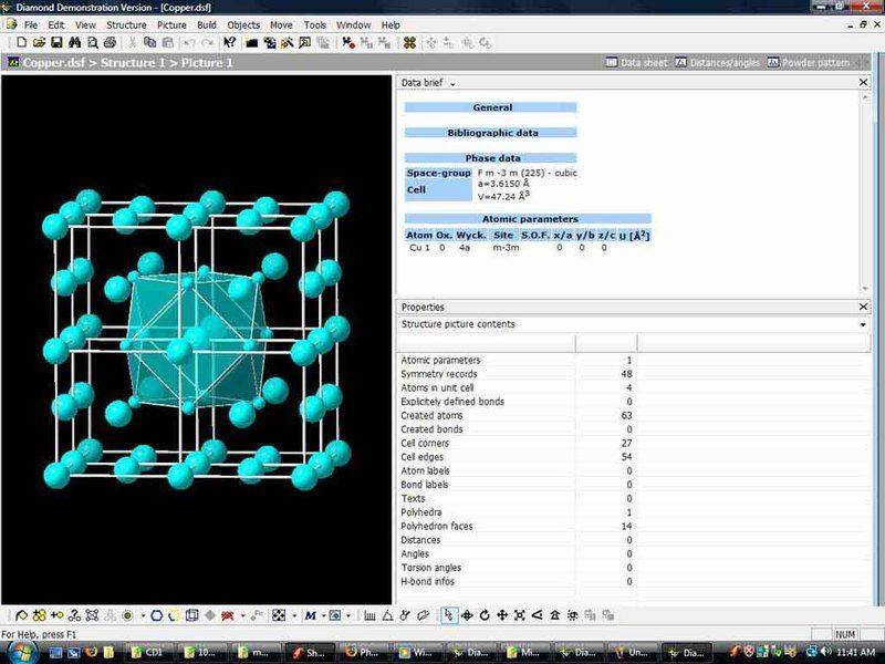

btw i remember using this software called 'diamond' that would let you look at the structure of molecules of minerals, twas pretty cool.
edit: iron and copper
just wondering what will you do once you have the structure of the alloy?
