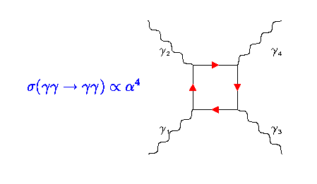

lethe, when you said "for each photon can turn into a virtual pair of electrons which annihilate back into photons. this is the box diagram." I looked up information about the "box diagram" and did not find anything on it.
i scoured the web with google, and found a picture
this is a purely electrodynamical effect. no gravity necessary.

right. so this is a second order quantum effect. a classical electromagnetic beam will not attract another one classically via an electromagnetic effect (although it will do so gravitationally)
Haelfix when you say the "feal (feel?) one another" what is the name of that method? I am interested in learning this material if someone would just point me in the right direction
Look up photon-photon scattering. it has been observed in the laboratory. i assume that the gravitational interaction between photons is many many orders of magnitude too small to be seen, so while it exists in principle, the box diagram will drown any signal out.
Yes, apologies, ignore what I wrote above... Silly brainfart at 6am in the morning. The box diagram is what is important for the interaction. And again, you should see intuitively why this is so, since the fields are being decomposed into charged pairs that should in principle know about one another electromagnetically (which is what I really meant and was describing above). One caveat though, this effect is highly suppressed for low energy photons energetically.
