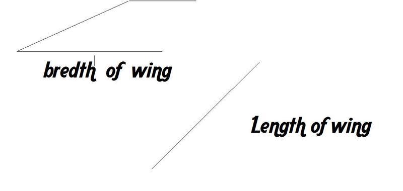

Hmmm... what I meant was since that since the lift depended on the angle of attack and area of the wing, if we were to increase the area of the wing linearly as in not the wingspan, but the actual breadth of the wing. These probably aren't the best words, what i mean is as illustrated in the diagram below...
So... if we can increase the breadth of the wing would we be able to increase the lift, sacrificing the drag? this is what i wanted to know...:smile:

You mean making the wings Deeper instead of Longer or Taller? Sort of like the space shuttle or the XB-70?
exactly... XB70?

Are you referring to increasing the chord length? I'm still a bit confused, even with your diagram.

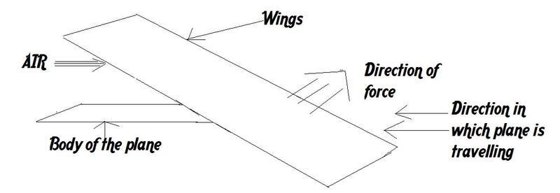

no actually what i meant by the whole vertical thing is that...
Why even bother with the whole combination of both the bernoulli and Newton thing and just instead use the Newton idea...
I hope this very poorly drawn diagram can represent the question I am trying to ask... :rolleyes:

Now it looks as if you're talking about a 'scissor-wing' (oblique) like the AD-1. Is this what you're getting at?
http://www.nasa.gov/centers/dryden/history/pastprojects/AD1/index.html"

The vertical dimension is thickness.
The front-to-back dimension chord.
The side-to-side dimension is span.
It sounds to me like you want to increase the chord. Is that correct?
If it is the chord you are looking to increase, the primary drawback of that is what the guys were discussing above: with a long chord, short span (aka, low aspect ratio) wing, the wingtip vortices are proportionally larger, increasing drag and decreasing lift.

yeah I did mean the "chord"... and well...
