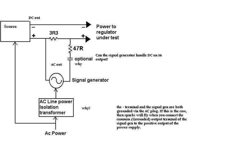

So I'm trying to do some regulator PSRR tests and for this i'll need a regular DC source with a ripple on it (say 200mv pk-pk) so i can compare this to the ripple at the output and someone suggested this circuit set up to me. My question is about the capacitor, i was told "a signal generator might not be able to handle DC on its output so a capacitor may be needed".First of all I'm not sure if this is true and second of all I'm not sure what it means or how a capacitor would solve this problem,and if it does how to figure out the capacitance to use.

If you directly connect the output of two signal generators, and they are producing different voltages, then very large currents will flow from one to the other. Of course, their limiting circuitry will kick in, and they will essentially turn themselves off.
Instead, you use a capacitor to couple one signal to the other. The capacitor blocks DC current, but permits the passage of AC current. You can use almost any size of capacitor; you just need to make sure that whatever RC filters are created do not significantly attentuate the AC signal you wish to pass.
- Warren
How much power are we talking here? Many signal generators will put out an AC signal with a DC offset. That's what I typically use for PSRR measurements on chips.
hmm! thanks chroot that makes a lot more sense now, berkeman my DUT sinks up to 1A and i want to test PSRR up to 20Mhz. do you think i could just connect my signal generator to my DUT?

The capacitor should block the DC offset, that's kind of what caps do(block dc).
It depends on the frequency you are looking to do, but you'll probably want to use a very small capacitance value, otherwise you'll start dropping the ac output across the cap.

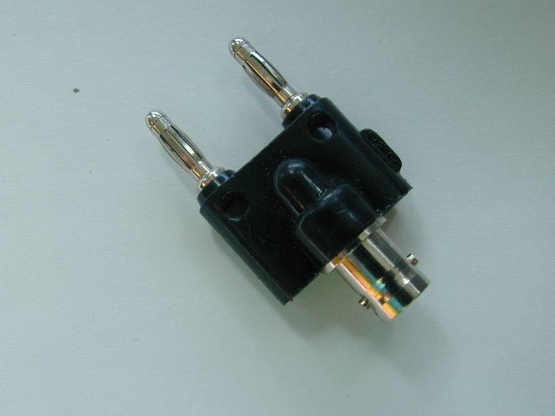

so if the center is the signal can i still slide it in my configuration somehow?
I've been looking everywhere for an op amp that is unity gain stable up to 20MHz and can source up to 1A.
I'd say put the center contact to the cap and the bnc shell to the resistor (even though this is all moot once you add an amplified(be it transistor or op-amp) to the circuit)
will this work
Probably, measure resistance from the center and the shell to the posts. If the shell goes to one and the center goes to the other then that should work. But as previously mentioned, I doubt the signal generator can source 1A.
