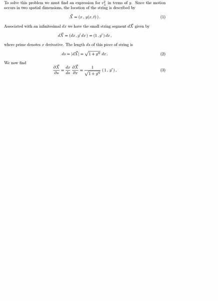

In the solution to problem 6.3 shown in the attachment, can someone explain to me why [itex]d\vec{X}/dx[/itex] was implicitly set equal to [itex]\partial \vec{X}/\partial{x}[/itex]?
Actually, the trouble begins before that. The unnumbered equation is wrong. They have
[tex]d\vec{X} = (dx, y' dx) = (1, y') dx[/tex]
but in the statement of the problem on page 114, Zwiebach has [itex]y' = \partial y / \partial x[/itex]. So the unnumbered equation should read:
[tex]d\vec{X} = (dx, y' dx + \dot{y} dt)[/tex]
From this, added to the fact that as you said, he needs [itex]\partial \vec{X}/\partial{x}[/itex] not [itex]d\vec{X}/dx[/itex], I think you can see how to finish up.
You are right. Then how do you get dx/ds when the expression in [tex]d\vec{X}[/tex] now has a time differential in it so you cannot use equation 2?

Don't use equation 2. Don't use equation 3 either. Use the chain rule to find
[tex]\frac{\partial\vec{X}}{\partial s}[/tex]
The first equality in equation 3 is the chain rule for that, isn't it? So, I still need dx/ds, don't I?

It isn't. It doesn't into account the fact that
[tex]\vec{X}[/tex]
also depends on time.
