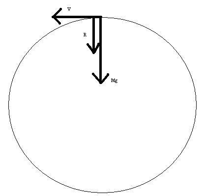

Hey, Simply I want to figure out what produces the reaction force, in this picture i drew, a reaction force appears directing in the same direction as the weight force, any ideas why? Sorry for the bad drawing
The example shows a cyclist going around a loop (upsidedown)
The track exerts a force on the bike.
Oh... its that simple... sorry haha
Yep. The combination of the force of the track and the weight of the bike create the centripetal force that keeps it going in a circle.
