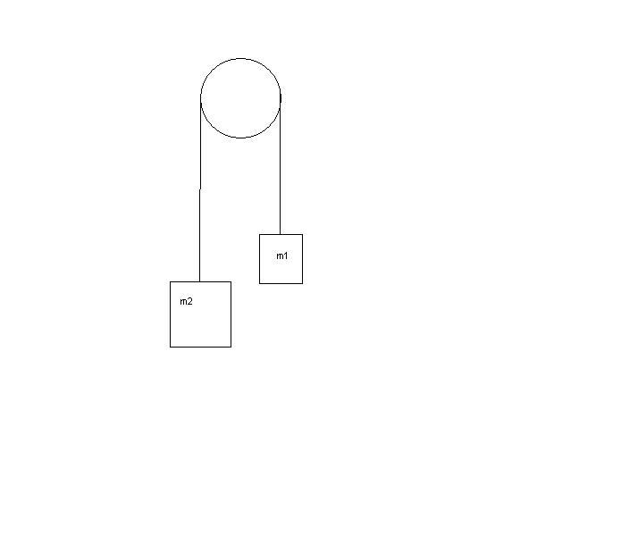

Two Masses are suspended from a pulley. The pulley itself has a mas of .20kg a radius of .15m a constant torque of .35 MN due to the friction between the rotating pulley and its axle. What is the magnitude of the acceleration of the suspended masses if m1= .4kg and m2= .8 kg (neglect the mass of the string)
Pulley
M2 M1
T1= M1G - M1A
T2= M2G + M2A
Torque= FL = Moment of Inertia x Alpha,
I= 1/2 mr^2
I have tried solving this by solving for A when T2-T1= I alpha, but i really don't know how to apply the fact that the tension is different of both cords due to the friction on the pulley I am stuck...
I have tried everything... but still i can't get to the answer.. i get to the formula a=(m2-m1)g/(1/2M+m1+m2) but after that i don't know how to apply the torque... :( need help
