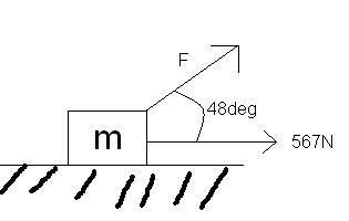

The last part of this problem has been bothering me. I don't understand how the work done by friction can be found if you are not given the coefficient of friction. Can anyone help me with this? There is a picture attached.
Sally applies a horizontal force of 567N with a rope to drag a wooden crate across a floor with a constant speed. The rope tied to the crate is pulled at an angle of 48 degrees relative to the floor. The acceleration of Gravity is 9.8 m/s^2. How much force is exerted by the rope on the crate in Newtons? What work is done by Sally if the crate is moved 34.1m? Answer in units of Joules. What work is done by the floor through force of friction between the floor and the crate? Answer in units of Joules.
567cos(theta) = F
W = F*d
So far I've found the answer to the first and second question.
Force of rope = 567/cos(48) = 847.3682038 N
Work done by Sally = 567*34.1 = 19334.7 J
I don't think that this last part can be done without the coefficient of friction. Am I wrong?

You don't need the coefficient of friction. Hint: The crate moves at constant speed.
That's something that I thought of too when I was working on the problem, but that makes me think that the answer is 0. But, I know that's not right. The only equation I know that gives the work done by friction is Wfk = -fk*d.

Nothing wrong with that equation. What's fk?
The Force of kinetic friction. But, I can't get that value without the coefficient.
Again, you don't need the coefficient since you're not going to calculate fk using (mu)*N. Instead you're going to figure out what fk must equal by analyzing the horizontal forces acting on the crate and taking full advantage of the fact that the crate is not accelerating.
The horizontal force on the crate is 567 N. The crate is not accelerating. The acceleration equals 0. Every sample problem in my book gives me the coefficient of friction. I really have no idea what to do. Maybe I do 567N/(9.8m/s^2), but that doesn't give me Joules.
In relation to the horizontal force being applied to the crate, what direction is the Force of kinetic Friction?
The opposite direction. That leads me to believe that the force of friction is -567 N, but that doesn't make sense to me because if the forces are opposite and equal, then the crate shouldn't be moving.

Not moving or not accelerating? If acceleration=o, then there are two possible cases: There are NO forces acting on the object or is no NET force on the object.

Is 567 the horizontal component of the Force exerted by Sally? Hint: No.
And [tex]F_k[/tex] is not WORK it is FORCE. If you have a force, how do you find the work done by it?

Ah, so I would do -567N*34.1m? The work done by friction would be -19334.7J then?

Is that what it says in the problem?! It looks to me like it says there is a 48 degree angle relative to the floor...
She is dragging the box horizontally; however, not ALL of that Force is directed horizontally...you need to decompose the vector.

Yes, it does say that she pulls a rope 48 degrees above the floor, but I'm not given that force, I'm given the horizontal component, which shows 567N. I attached a picture, but maybe it isn't working. I found the force along the rope to be about 847N, but that is not horizontal.

I am very sorry. I just went downstairs and looked at my PC instead of my Mac and I can see the image. -567N*displacement is the correct answer.
