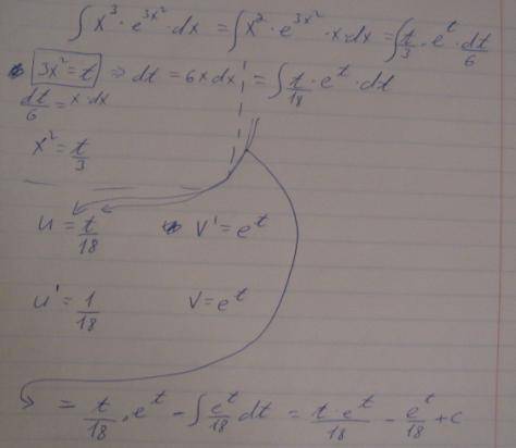

integrate: (x^3) e^(3x^2) dx
uv- integral vdu
i've tried this many times on paper and can't get the right answer. I'm starting to get really frustrated. Please help, and be specific as possible.
Since you haven't shown any work I'll assume the worst :s.
First you should make a substitution if possible, to get just e^t.
And when you have an integral of the form:
[tex]\int x^n T(x) dx[/tex]
where T(x) is a Transcendental function (e^x, sin x, cos x, a^[bx+c], ln x, etc..). And it's antiderivative should be easier than the entire function, otherwise you'll go from a hard integral to a harder one.
to solve that type of integral you need to make the substitutions:
[tex]u=x^n[/tex]
[tex]v'=T(x)[/tex]
and you will need to integrate n times, continue with u=x^n and eventually you will get rid of the x term and have only T(x) which would be a trivial integral. ex. [tex]...-\int cos x dx[/tex]
Also when integrating and say you have [tex]-3\int x^n cos 3x dx[/tex] don't just choose u=x^n; v'=cos 3x, place that coefficient on either u or v' to maybe cancel it out. A better choice would be u=x^n; v'=-3cos 3x, which gives u'=nx^(n-1); v=-sin3x
This way you don't have to worry about multiplying everything by that - sign, you might forget it and get the entire thing wrong :/
My advice is to rewrite the integral as this
[tex]\frac{1}{6}\int x^2(6xe^{3x^2}) dx[/tex]
and then use integration by parts
Here is a nice hint to help you
[tex]\frac{d}{dx}(e^{3x^2})=6xe^{3x^2}[/tex]
this is my solution
i added a file with my solution
could you just write it out? usually it takes a while before attachments are approved.

even easier is to separate x^3 into x * x^2 and then set u = x^2. then use integration by parts
