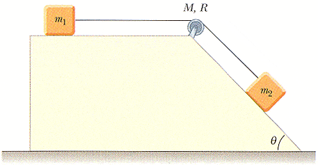

4. Homework Statement
A block of mass m1 = 2.45 kg and a block of mass m2 = 5.55 kg are connected by a massless string over a pulley in the shape of a solid disk having radius R = 0.250 m and mass M = 10.0 kg. These blocks are allowed to move on a fixed block-wedge of angle θ = 30.0°. The coefficient of kinetic friction is 0.360 for both blocks. Draw free-body diagrams of both blocks and of the pulley.
(a) Determine the acceleration of the two blocks.
(b) Determine the tensions in the string on both sides of the pulley.
Left:
Right:
4. Relevant equations
? If someone could just point me in the right direction on the last three...4. The attempt at a solution
Well, take #4 for example: you need to sum up the torques on the pulley, using [tex]\Sigma \tau = I \alpha[/tex]. You also need to sum forces on each block in each direction using Newton's second law. Draw your free body diagrams very carefully here. Once you have all of those expressions, you will then be able to combine the information to get the acceleration.
