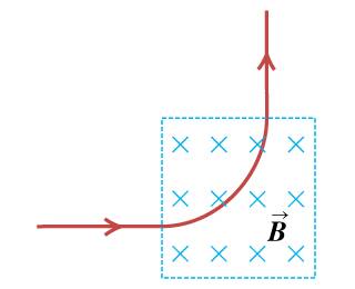

A beam of protons traveling at 1.20 km/s enters a uniform magnetic field, traveling perpendicular to the field. The beam exits the magnetic field, leaving the field in a direction perpendicular to its original direction. The beam travels a distance of 1.30 cm while in the field.
What is the magnitude of the magnetic field?

how can you relate acceleration with what you are given in the problem we are given "v" and we are also given "r". the acceleration is purely centripetal so the velocity does not change
the only other thing is it doesn't say it made a radius of 1.3 so you would have to find it using arc length formula

would i be correct in saying that using the arc length formula:
pi/2 radians is equivalent to 1.3cm
θ = s / r
r = s / θ
= 1.3 / pi/2
r = 0.8276 cm

r = mv/qb
0.008276 = (1.67x10^-27 x 1200) / (1.602×10^−19 x b)
(1.602×10^−19 x b) = (1.67x10^-27 x 1200) / 0.008276)
(1.602×10^−19 x b) = 2.42146x10^-22
b = 1.5115x10^-3
that was correct :)

Here the force is centripetal force.
SO qvB= mv^2/r
B = mv/qr
substitute the values. See how much you get.
