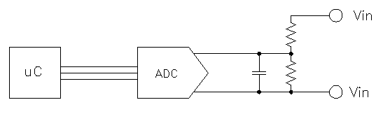

Hello All,
I'm working on a circuit that can detect a voltage input and convert it to a digital value that my micro-controller can read. But I'm having some trouble finding the right Analog to Digital converter IC to use. I want the circuit to be able to detect a positive or negative voltage difference of 5V across a resistor in a voltage divider.
The voltage divider is designed to handle an input range of 0 to 1000V so I am dividing it down 200:1 so that the maximum voltage I need to detect is 5V. (see attached image).
Ideally, I want the voltage divider circuit to be completely isolated from the circuit ground in case there are any spikes or other noise that could booger up my circuit, so I'm trying to find a ADC that can measure a differential input that is isolated from the ground line. Other requirements are that it be 12-bit, come in a DIP8 package (so I can socket it and replace it if/when I blow it up), and that it have a Serial interface to connect to my controller. Also it doesn't need to be blazingly fast since I am using a BASIC stamp to clock the data from it (I think the serial interface on those runs only at 14kHz). It would be great if someone here could give me some pointers in the right direction, as there are a dizzying number of different ADCs out there and I've just began my search for the right one.
Thanks,
Jason O

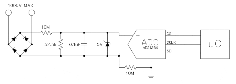

Update,
Ok, I'm simplifying my life by not caring about the polarity of the voltage. I attached a new circuit diagram below showing my new idea. Basically, I'm just rectifying bumping down, and filtering the input voltage so I can read it safely. I also added a zener diode to clamp any spikes or over-voltages that may occur just in case the filter doesn't get everything.
To protect the ground line from current surges, I added a 1M resistor between the negative ADC input and the circuit ground. Does this look like it would be good enough to safely protect the circuit from the input?
Thanks,
Jason O
Yoiks. First, I'd recommend using a step-down transformer from the AC high voltage down to a lower voltage to be digitized. That would be the traditional way to do this, so that UL safety regulations could be met. If that is not possible for some reason, then you should put your voltage divider first (before the rectifier that you show), and shield the hot parts (HV stuff) of the circuit from any possible human contact, and only expose the low voltage, low current stuff that goes into your ADC.

I would go with a step-down transformer but this circuit must be able to meausre both DC and AC input. As for the rectifier, Since I'm ultimitely dividing a maximum input of 1000V down to 5V, I'm very concerned about the voltage drop that the diodes will present to the ADC inputs, if they drop 0.7V, then wouldn't that mean that all the measured values below 140V would get cut out? If I leave the diodes on the HV side of the diodes, I don't have to worry as much about the drop since using a 12-bit ADC gives me roughly 1-volt resolution through the whole range. Also, I'm not expecting to measure 1000V in regular use, I just wanted the circuit to be able to handle it if the input ever gets that high. realistically, I will be dealing with voltages between 50-300V. As far as shielding goes, are you referring to isolating the input from the circuit?

What is the maximum AC bandwidth? That will have a bearing on the resistors that you use for the dividers, and on how much parasitic capacitance you can tolerate.
It sounds like the way to go is to use a large divide ratio (with resistors big enough to limit the current significantly), and use an ADC with split supplies so that you can digitize both positive and negative voltages. Your sample and hold circuit before the ADC (if it's not built into the ADC you are using) will also need to run off of the split supplies.

Ultimately the AC bandwidth is not important since its intended use is primarily for measuring DC voltages. But in practice, most of the voltages will likely look like noisy pulsed DC voltage, which could have AC components and ringing in it. So, ideally I just want to filter out some of the noise and get a fairly decent DC reading. It doesn't have to be totally accurate but just good enough to give me a good idea of the voltage I am measuring. I am mainly interested in the magnitude of the voltage, though in a perfect world, it would be nice to know what the polarity is too.
I wouldn't mind finding a nice ADC that can measure +-V on the input, but I want to avoid adding a negative supply on my board since I am cramped for space. If possible, it would be nice if they made an ADC that would measure +-V and run on 5V. The other concern that comes into play is the resolution. I would need something that has 24-bit resolution so that I can still get the 1 volt resolution that I would like for both positive and negative values. Do you know of any ADCs that would meet these requirements? I've been looking all over but I'm sure there's got to be something like that out there. The last constraint is that I want something that comes in an 8-pin DIP so I can socket it (and replace it) if/when I blow it up. Or if surface mount, something I can solder onto an adapter board and plug into an 8-pin DIP socket for easy replacement.

Add clamping diodes at the input of the ADC or at the input of the amp that drives the ADC. For example, if the max input voltage (after scaling down) is 1V, then add 2 back to back High voltage diodes at the +ve input of the ADC. In case the resistors at the Voltage divider open, the diodes clamp the HV.
One clamping diode is enough at the -ve input.
Just curious, what's the reason for the 10M resistor from ADC -ve to ground?

Actually, I spoke to someone about that 1M resistor and I doesn't need to be there. my original thought was to limit any currents that could get onto the ground line from the input (HV spikes or whatever).

By the way, I also reaized that I will need a bit more current to flow through the resistor divider so that the rectifier diodes will turn on, so I lowered the resistor values to 1M and 5.03k to give a current draw of rougly 1mA at 1000V (which is just the max input), realistically, I will usually be around the 50-100V range for what I'lll be experimenting with, in which case the current draw will be much lower. Are there any optical isolation devices that operate on extremely low currents?
