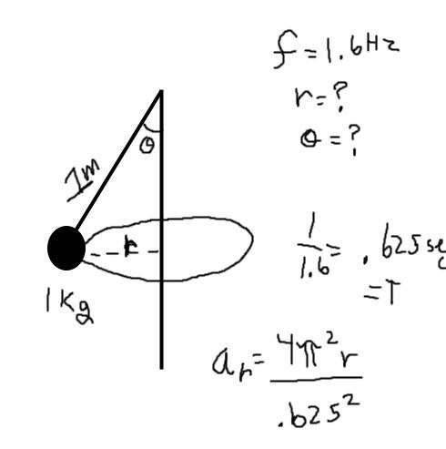

This is a concept/procedure question. I am playing teth3rbalI with a 1 kilogran ball and it is tied to a meterlong string. When I hit the ball it circles the pole at 1.6 Hz. Find the anglethat the string makes with thepole.
a[tex]_{r}[/tex]=v[tex]^{2}[/tex]/r
a[tex]_{r}[/tex]=(4[tex]\pi[/tex][tex]^{2}[/tex]r)/T[tex]^{2}[/tex]
T=1/f
f[tex]_{r}[/tex]=ma[tex]_{r}[/tex]
So I found the period for one cycle but that's basically it and I'm stuck without a radius or at least a velocity to go by. What am I overlooking?

The whirling string has to make an angle, say 'x', with the vertical in the downward direction. It lies on a cone, whose semi-vertical angle is 'x'. If 'T' is the tension in the string, then mg=T*cos(x). The centipetal force is T*sin(x). The mass m travels in a horizontal plane.

since Tcos(x) = mg then Tcos(x) = 9.8 N and since T sin(x) = centripedalforce then Tsin= 1kg((4[tex]\pi[/tex][tex]^{2}[/tex]r)/(.625[tex]^{2}[/tex]))
I'm slightly nervous proceeding since my next move would be to do a pythagoras of 9.8[tex]^{2}[/tex] + ((4[tex]\pi[/tex][tex]^{2}[/tex]r)/TimePeriod[tex]^{2}[/tex])[tex]^{2}[/tex] = T[tex]^{2}[/tex] which doesn't seem right nor does it make me any more confident.
kk think i got it but does the mass cancel out?
It'd be neater if you didn't write the values of g etc in every step. Use symbols and plug in the values later.
Yes, the mass cancels out.
The centripetal force is m*w^2*r= T*sin x.
tan x = Tsin x/Tcos x = mw^2*r/mg =rw^2/g.
You know the value of r, and w is given.
If you look at Shooting Star's post this should become apparent.
