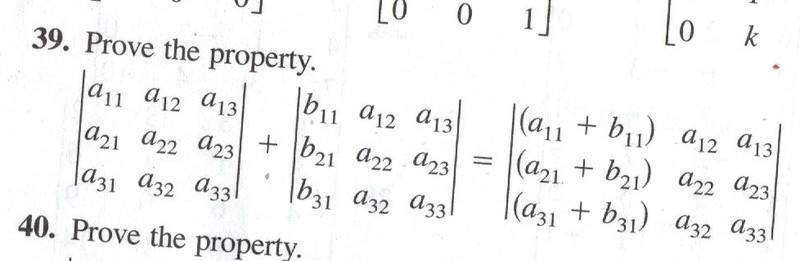

I need help with proof. Can anyone lead me in the right direction?
http://i153.photobucket.com/albums/s208/nailbomb2/LastScan.jpg
The determinant is a multilinear function of the columns. That means every term in the polynomial expansion of the determinant contains exactly one entry from the first column. How's that for a direction? Think about expanding by minors.

Can you do the 2x2 version of your question? The 1x1 is easy.

Do you know how to "expand by minors"? If so find the determinant on the right by expanding along the first column.
Look up 'expansion by minors'. You can turn the first 3x3 determinant into a sum of three 2x2 determinants a_11*A_11-a_21*A_21+a_31*A_31, where A_ij is a 2x2 determinant that doesn't include any elements of the first column. The second one is b_11*A_11-b_21*A_21+b_31*A_31. The important thing is that the A determinants are the same.
