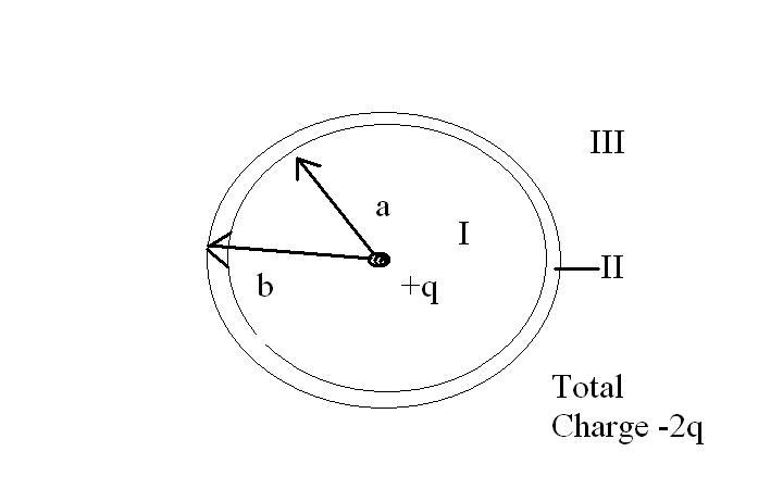

Hi, I am really stuck with these problems, is it possible you guys can help me out, by guiding me along this problem, I wil write the entire thing out, but would appreciate it if you guys help me step by step so that I can understand it, since I am having a VERY hard time with these problems.
A point charge (+q) is located at the origin. A spherical conductor of inner radius "a" and outer radius "b" surrounds this point charge with its center at the origin. A total charge of =2q lies on this spherical conductor.
{I put the diagram as an attachment}
a) Find the magnitude of the electric field in region I, at a distance r<a away from the origin. Label on the diagram some E field line within this region, if necessary. [Hint: Use Gauss Laws]
b) Find the magnitude of the electric field in region II, at a distance r>1 (but <b), from the origin. Again label on the diagram some E fields if necessary.
c) Find the magnitude of the electric field in region III, at a distance r>b from the origin. Again label on the diagram E field lines if necesary.
Consider 2 different designs for a printer cable. Design 1 has 4 cables each carrying a current I into the page. Design 2 has 4 cables all carrying current magnitude I but two have the current in one direction and two have in the opposite direction.
d) Find the magnetic field at a distance r. (in the plane which is perpendicular to the wires), away from cable 1 by using Ampere's Law.
e) Find the magnetic field a distance r away from cable 2 by using AMpere's LAw.
f) Which design is better, why?

Ok, I 've been working on it and well, I got to this point, but am not too sure.
a) sigma E perpendicular delta A = E * sigma delta A = E(4*pi*r^2) = Q / epsilon
So wouldn't the charge in section I be +q / epsilon?
c) sigma E perpendicular to delta A = E * sigma A = E * (4 pi r^2) = Q / epsilon
so E = 1 / [4 pi r^2] * Q / b
so, doesn't this tell us that the field outside the uniformly charged spherical shell is the same as if all the charge were concentrated at the center as a point charge??
So that would mean that it is -2q?
I am not too sure

The charge contained within that surface is given as +q. So solve for E.
That's correct. (The formula has a typo: You have b instead of epsilon.)
What's the total charge within the Gaussian surface when r > b?

To find the total charge within a surface with r > b, just add the charge at the center (+q) to the charge on the conductor. (What's the charge on the conductor?)
The charge on the conductor is -2q, so +q + -2q will be -q so that is the charge in region I?

No, that's the charge within a sphere of radius r > b. Region I is within r < a; the only charge in that region is the center charge of +q.
Note: The regions are for the purpose of defining the field. For finding the charge, use a Gaussian sphere of the appropriate radius, counting all the charge within that radius.
Ohh, ok, I think I understand now, so for region II the charge would be -2q since that is the charge of the conductor

Careful here: What's the field in region II? (Hint: What's the field within a conductor?)
While the total charge on the conductor is -2q, where is that charge located? What's the charge on its inner surface? Its outer surface?
The E field in a conductor is zero right?
Exactly. So part (b) is easy.
