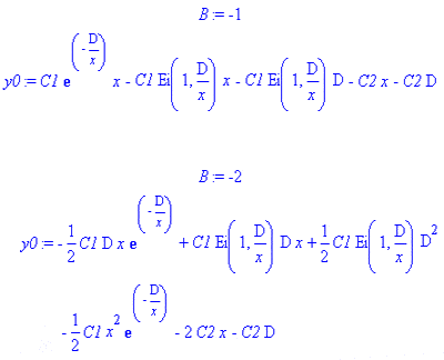

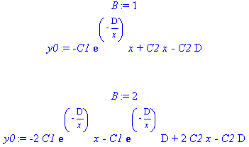

solutions
Well, guys, I'm terribly sorry for the delay.
The _general_ solution for the equation
x^2*y''+(B*x-D)*y'-By=0
(I changed C1 to D, Cn are usually integration constants)
is: (see y0BD.gif).
I provide you also with the solutions for B=0,+-1,+-2.
Maple 9 doesn't want to give the explicit solutions if B is not integer.
Best of luck,
Max.
Definition of Ei(a,z)
This is a definition for Ei(a,z) used in solutions.
Max.
