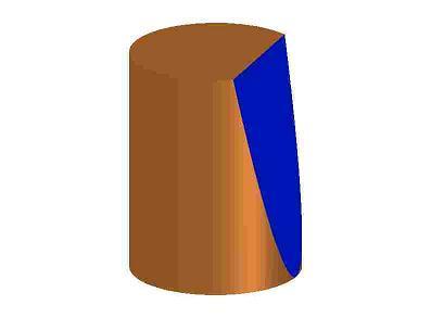

i'm trying to calculate the volume of material that was shaved off a solid cylindrical temperature thermowell. looking from the side, a triangular portion was cut off at an angle from the top down.
knowns:
the diameter of the cylinder is 1.1 cm
the height of the cylinder is 0.8 cm
looking top down at the cylinder, perpendicular to the measured diameter, the circle is cut 0.4 cm from the side of the cylinder, leaving the remaining 0.7 cm intact.
the cut was at such an angle (approx 63 deg by my calcs) that it exited the thermowell 0.8 cm down from the top.
what is the missing volume? as mentioned before, any help is appreciated...

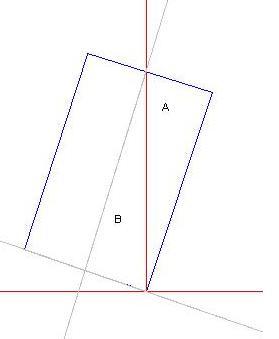

Ok, what about this? I've rotated the axes system so that the line I was previously talking about now lies on the Y axis. You need to find the equations of the two dashed lines, and revolve them around the new Y axis. The volume you get divided by half should be the volume that was removed from the cylinder.
that won't work Chen.. if you do that, you'll be revolving a different shape than what was removed
its hard to explain, but think about it, the shape will be different... you have to revolve it around an axis which is parallel to the long side of the cutout inorder for the shape to be the same

Isn't that what I did? By rotating the axes system, I made the Y axis lie on the long side of the cutout... or doesn't it? :confused:
Try this.. rotate sections A about the GREY axis

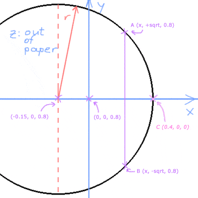

Ok, here is what I did. I defined an XYZ space as described in the attached image. The equation of the circle in the XY plane, with a radius of 0.55 and the center located at (-0.15, 0) is:
[tex](x + 0.15)^2 + y^2 = 0.55^2[/tex]
The value of Y for every X is then:
[tex]y = \pm \sqrt{-x^2 - 0.3x + 0.28}[/tex]
From now on I will refer to that expression as "sqrt" for sake of simplicity. So now every point on the circle can be described as (x, sqrt, 0.8). I've defined another point (0.4, 0, 0) which is located at the bottom of the cylinder, on the circle's perimeter.
Let's consider two points on the top circle perimeter, A (x, +sqrt, 0.8) and B (x, -sqrt, 0.8), and the bottom point C (0.4, 0, 0). If we connect these points we create a triangle. The missing volume from the clyinder is actually the sum of areas of all these triangles, for x running from 0 (beginning of cut) to 0.4 (end of it).
So first we need to find the expression for the area of those triangles. If we create a vector AC and BC, then the area of the ABC triangle is:
[tex]S_x = \frac{1}{2}|\vec{AC} \times \vec{BC}|[/tex]
Where:
AC = (x - 0.4, +sqrt, 0.8)
BC = (x - 0.4, -sqrt, 0.8)
I don't know how to write the calculation here, so you will just have to trust me that:
AC x BC = (0.8*sqrt, 0, 0.4*sqrt - x*sqrt)
Where x is the X coordinate of the points A and B. So now the magnitude of that vector is:
[tex]|\vec{AC} \times \vec{BC}| = sqrt\sqrt{x^2 - 0.8x + 0.8}[/tex]
And thus the area of every triangle is:
[tex]S_x = \frac{1}{2}|\vec{AC} \times \vec{BC}| = \frac{sqrt}{2}\sqrt{x^2 - 0.8x + 0.8}[/tex]
And if we use the real expression of "sqrt" we get:
[tex]S_x = \frac{1}{2}\sqrt{(-x^2 - 0.3x + 0.28)(x^2 - 0.8x + 0.8)}[/tex]
[tex]S_x = \frac{1}{2}\sqrt{-x^4 + 0.5x^3 - 0.28x^2 - 0.464x + 0.224}[/tex]
And finally, we need to find the sum of all these areas for x from 0 to 0.4:
[tex]V = \frac{1}{2}\sum_{x = 0}^{0.4}S_x = \frac{1}{2}\sum_{x = 0}^{0.4} \sqrt{-x^4 + 0.5x^3 - 0.28x^2 - 0.464x + 0.224}[/tex]
And this is where I'm stuck because I don't know the formulas for the sums of x4 and x3. :frown:
Anyway, I hope this has helped... and not caused too much confusion. I may have gone about this in the wrong way, but I believe it's correct. And at least with this answer you got a definite expression. :smile: Let me know how it works out, and if anyone can spot an error in my logic/calculations please do let me know.

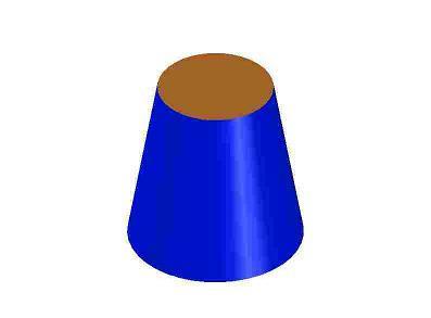

Just take few moments to analyze the two cases (images attached)
if it is the first case you are wondering about, well, then it does need some thought but if it is the second one then it's easy.
1) take a cylinder with the same height and radius 'r1' (base radius being 'r2' and r2 > r1) and find the volume.
2) take a right triangle of the same height and base equal to r2-r1, multiply the area of this rectangle with '2 * pi * (r2- (2/3)(r2-r1))' to get a volume of revolution.
add the volumes calculated in the above steps, to get the volume left in your part
