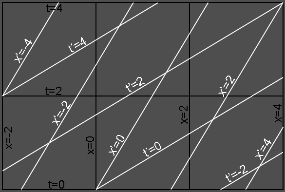

Hi Joanna,
I don't want to get into the specifics of your questions, I think that you need some overall framework in which to understand relativity rather than specific details which will naturally fall in place once the framework is in your mind.
Please look at the attached image. It is fairly simple, but represents in one geometric figure all of the predictions of relativity. You can generate this figure yourself (in fact, I would encourage you to do so as it is educational), it is simply a Lorentz transform with one spatial dimension (horizontal) and one time dimension (vertical). What we have here is two reference frames, the black unprimed frame and the white primed frame. Here the units are not really specified but it is in any unit system where c=1. The primed frame is moving at 0.6c to the right wrt the unprimed frame.
As you can see the geometry is fairly straight-forward and simple. More important it is self consistent. Any one pair of (t,x) coordinates maps linearly to one pair of (t',x') coordinates and vice versa.
I have to go and hang out with my family, but let me leave you with this challenge: can you look into this diagram and see what is meant geometrically when we say that a moving clock ticks slower? Can you further see that from the perspective of both the primed and unprimed frames?
I will follow-up later.

I can understand how this geometric figure shows moving clock ticks slower and I think the x/x1 coordinates shows length contraction. I don't have a problem understanding how it works, just why it works. That seems to be the most difficult explanation to formulate or even pose the question asking for an explanation.
What do you mean you don't have a problem understanding how it works? That's what this entire discussion is about! Are you just teasing me? :wink: Do you really understand how it's possible that both observers can see the other's clock run slow?
I don't know what you mean by why it works or what kind of explanation you are looking for. All I can do is help you understand how it works, and how it's a consequence of the principle of relativity and the constancy of the speed of light.
Regarding Dale's spacetime diagram and understanding relativity: In my view there are three paths to understanding the basics of special relativity. (a) In terms of the Lorentz transformations, (b) in terms of the basic properties of moving clocks and metersticks, and (c) in terms of spacetime diagrams. You need all three. (In my opinion, only after you are comfortable with spacetime diagrams will you really understand how things work.)
In this thread, I suspect we are trying to follow path (b)--an excellent way to go.

Certainly, just draw the spacetime diagram. I already laid out the coordinate system in https://www.physicsforums.com/showpost.php?p=1620834&postcount=13", so all you have to do is add the worldlines of whatever you are interested in.
Returning to the diagram (and apologizing in advance for such a long post). There are three important aspects of the Lorentz transform, all of which are demonstrated in the diagram. They are time dilation, length contraction, and the relativity of simultaneity. I will skip length contraction for now, and focus first on time dilation.
Begin at the origin (t=t'=0, x=x'=0) and follow the x'=0 line. This is the worldline of a clock that is stationary in the primed reference frame (moving at 0.6c in the unprimed frame). Note that, as you travel along this line it intersects with the t=2 line before it intersects with the t'=2 line. In other words, in the unprimed frame the primed clock (moving at 0.6c) is slow: time dilation.
Now, begin again at the origin and follow the x=0 line. This is the worldline of a clock that is stationary in the unprimed reference frame (moving at -0.6c in the primed frame). Note that, as you travel along this line it intersects with the t'=t line before it intersects with the t=2 line. In other words, in the primed frame the unprimed clock (moving at -0.6c) is slow: reciprocal time dilation.
"Illogical nonsense" you say! Well, the simple fact that you can draw a self-consistent geometrically correct diagram showing both effects simultaneously implies that it is not illogical. So how is it possible that the moving clock in each frame is slow? The first thing to notice is that the measurement of a "moving" clock's rate requires at least two synchronized "stationary" clocks (otherwise you have to compensate for light-travel delays). So, for example, when we are looking at the unprimed frame the primed clock reads 0 when it passes the x=0 clock (which reads t=0) and then the primed clock reads 2 when it passes the x=1.5 clock (which reads t=2.5). A similar situation happens when we look at the other frame. In both cases measuring the rate of a "moving" clock requires at least two synchronized "stationary" clocks.
This brings us the final and most important aspect of the Lorentz transform, the relativity of simultaneity. Note that the t' lines are not parallel to the t lines. This means that two events which are simultaneous in one frame will not be simultaneous in another frame. In particular, a pair of clocks which are synchronized in one frame will be out of synch in another frame. Again, at least two "stationary" clocks are required to measure the time dilation of a "moving" clock. Since those two clocks are synchronized in their rest frame but not in the moving frame the second clock effectively has a "head-start". So the relativity of simultaneity is the unifying feature of the Lorentz transform that allows both frames to logically, simultaneously, correctly, and self-consistently claim that the other clock is slow.
