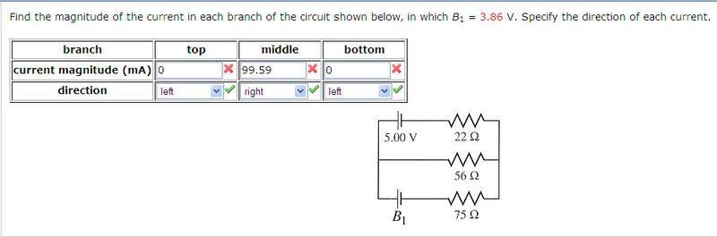

Find the magnitude of the current in each branch of the circuit shown below, in which B1 = 3.86 V. Specify the direction of each current. (See attached image)
V=IR
Kirchhoff's rule
I labeled the points in the circuit starting in the lower left hand corner with A, then going up to the first junction B, and so on. Hopefully that makes my explanation make more sense.
I went ahead and chose E as my junction point (the junction point on the right) to give me the equation:
I2-I1-I3=0 or I1=I2-I3 (1)
Then I looked and the bottom loop, starting in the lower left hand corner going up. I got:
-I2R2-I3R3+E1=0 (2)
I next looked at the loop starting at point B and going up. I got:
-E2+I1R1+I2R2=0 (3)
I substituted equation 1 into equation 3 (giving me equation 4). I then multiplied both sides of equation 4 by 75 and both sides of equation 3 by 22 in order to get matching coefficients on the I3 term. I then subtracted those two equations to eliminate I3, giving me:
4618I2=459.92
I2=99.59mA which was incorrect.
I spent a lot of time on this and can't figure out where I went wrong, ant help is appreciated, and I will clarify anything that doesn't make sense. Thanks.

You should get three equations for the three unknowns. It looks like you have two, though the loop descriptions are ambiguous (going up?). There are three loops you can go around, all of which you know from Kirchoff's Voltage law must sum to zero. I'll give you two of them. Let me name the currents I1, I2, and I3 from bottom to top, and have them all go right (the signs will work themselves out later), from KVL I get:
Loop one is going around the bottom half of the circuit starting at the battery:
-EB+56I1+76I2=0
Loop two is going around the top half of the circuit starting at the 56Ω resistor:
-56I2+5V+22I3=0
Can you do the third one? Are you familiar with linear algebra (some high school algebra classes cover it)?

I was trying to use Kirchhoffs current rule for my first equation, where at the junction point on the right in the middle I2-I1-I3=0. But I see where I could use the third loop. Is -EB+75I1-22I3+5=0 correct?
I am kind of confused where you wrote -EB+56I1+75I2, doesn't the 75 ohm resistor correspond to I1?
Thanks for the help so far.
Oh, whoops I accidentally switched the resistors. It should be
-Eb+56I2+75I1
Yes your equation is correct. Now you just have to go through the algebra, which you can do with substitution at this point, but it may take awhile.
I'll give you one of the answers in a sec that may help you, though you really ought to learn about procrastination. :p
Okay, you should get 62mA for the top current, but if I made a mistake you are in trouble as you only have 15 mins.
The bottom ought to be 3mA and the mid ought to be 65mA.

I actually used a technique called mesh current analysis which went a little faster. But yeah, the idea is that once you get one of the answers you can just put it into the other answers. A quick way to solve systems of equations is with linear algebra techniques, Gauss Elimination probably being the best. To learn them requires a couple pages of writing I'd rather not do, but you could probably look it up.
Gaussian Elimination is a good one. You can also use Kramer's rule, or if you have a calculator that can do matrix, that would be the easiest method.
