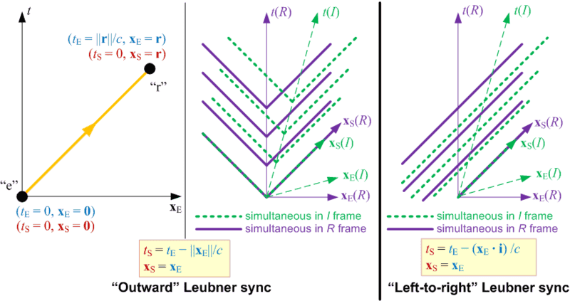

You seem to have got the light going the wrong way, to the origin instead of from the origin, which is what I thought Leubner was doing. But apart from that, your equation (1) is essentially the same as my "equation for outward sync" in my last post.
The attached diagram may help explain my notation and the equations I've used.
The left-hand diagram shows the "outward" synchronisation procedure with light going from the origin ("e") to a second clock ("r") (at a fixed position r relative to the origin). In s-coordinates, the second clock is synced so that a person at the second clock sees, with their eyes, both clocks synced.
The centre diagram shows the surfaces of simultaneity (thick lines) for observers in two different frames (I=green[/color] and R=purple[/color]). Where the two sets of lines are parallel we have absolute simultaneity. Note that there's a region (x(R)x(I) < 0) where the lines are not parallel (except for the surfaces through the origin). The situation is even worse if my diagram is considered as a 2D cross-section of 3D cones (or 4D hypercones). So "outward" Leubner sync does not give absolute simultaneity everywhere, only within some regions of spacetime.
One other thing wrong with "outward" Leubner coords is that they are not "inertial", in the sense that inertial motion does not give a constant velocity. An inertial object passing through the origin would show a sudden change of speed in "outward" Leubner coords.
The right-hand diagram is the same as the centre diagram but for "left-to-right" Leubner sync, i.e. when the sync signal always travels in the positive x direction i, instead of outward from the origin. In this case we really do have absolute simultaneity everywhere, and the coordinates are inertial.
For the above reasons, in my opinion the polar [itex](r, \theta, \phi)[/itex] approach is not worth considering if your objective is to obtain absolute simultaneity everywhere.
