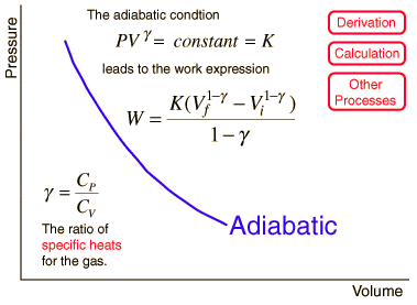

What is the work done during an ADIABATIC process... ?
Is it really (P deltaV) ?
Have a look...

I see now that I was wrong to assume pressure is constant, but I'm afraid I'm still a little lost with the symbols and stuff.
What does PV^gamma mean? Is gamma an exponent? And if so, do I need to figure out what both P and V are on their own?
And what constant do they equal? My textbook says (5/3) in the chapter about adiabatic-ness.
In the equation beside the graph, how do I find Vfinal and Vinitial without being given a pressure?
