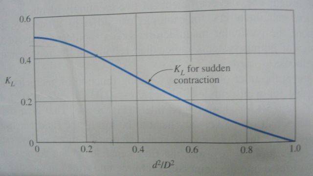

Hi, I am an undergraduate, doing an experiment regarding of minor losses due to sudden contraction. However, I found that my theoretical loss is higher than the experimental loss.
The flow rate = 3.28*10^-4 (m^3/s)
(Inner diameter) D1= 3.652*10^-2 m
(Inner diameter) D2= 1.539*10^-2 m
by using the energy equation
[tex]\frac{P_1}{\gamma}+\frac{V_1^2}{2g}=\frac{P_2}{\gamma}+\frac{V_2^2}{2g}+h_L[/tex]
rearranged
[tex]\frac{P_1}{\gamma}-\frac{P_2}{\gamma}=\frac{V_2^2}{2g}-\frac{V_1^2}{2g}+h_L[/tex]
I assumed that major head loss/friction head loss negligible since the length between to the two points is only 50mm.
SO [tex]h_L[/tex]= minor loss
[tex]h_L=K_L\frac{V^2}{2g}[/tex]
Based on the charts given in the book, Fluid Mechanics by McGrall Hill. I found that [tex]K_L[/tex] roughly equals to 0.45 and V=the velocity of the smaller pipe.
By using all these, I calculated the pressure difference = 0.22m
But my experimental result = 0.159m
Could anyone help me with this, I expected my experimental results would yield bigger pressure difference, yet it gave me less.

My set up is build to study sudden contraction not gradual contraction, the chart in the book is also for sudden contraction.
I have include an attachment of the chart I used.
Sorry, didn't see the sudden part above. However, the angle is still used in the calculation of K. If it is sudden, then the angle is just 180 degrees.
Your discrepancy may be due to you reading the value off of the chart and not actually calculating it.
Just calculate it yourself and don't use the chart.

According to Crane's, for a 180° contraction (actually for angles 45° to 180°), the loss coefficient is:
[tex]k=\left[\frac{0.5(1-\beta^2)\sqrt{sin\left(\frac{\theta}{2}\right)}}{\beta^4}\right][/tex]
Where
[tex]\beta[/tex] is the diameter ratio
[tex]\theta[/tex] is the angle of contraction
Ah, Fred beat me to it.
BTW the K is with respect to the larger diameter pipe.
CS
So what you mean is that the K I found through Crane's, the V, I should use is with respect to the velocity of the larger diameter pipe?
In that case value I found for [tex]h_L[/tex] is 0.065m, Some difference between the one I calculated using the chart, which is 0.071m.
