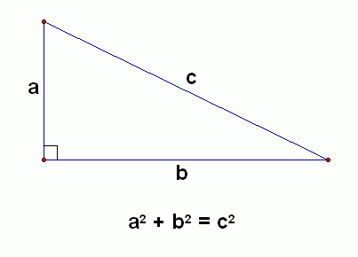

Does the theorem still hold true, but triangle sides are curves?
The theorem won't hold as written anymore.
Working in a non-euclidean space doesn't imply that straight lines (i.e., geodesics) will appear curved. Minkowski space[time] is a non-euclidean space.
… Pythagoras on a sphere …
Hi Ulysees! :smile:
The surface of a sphere is a good example of a non-Euclidean space.
The equivalent of Pythagoras' theorem is cosC = cosA.cosB.

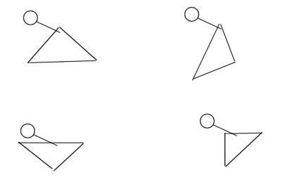

For example, let's take a wire shaped like a triangle, like a hanger for clothes, with a top angle of 90 degrees. We can put this hanger on a nail on the wall in various ways:
You are saying that the model where there is a constant Earth "force" of gravity is false, and the model where there is a varying inverse-square "force" of gravity is false too, and that the reality is that the space of the triangle is curved. I suspect that the GR model does not produce more accurate predictions as to where the triangle will balance in the bottom-right case. Compared to the Newtonian model of an inverse-square force of gravity, the prediction should be the same I suspect.
So let's do this problem correctly then (ie according to GR, and not the false Newtonian euclidean-space force mechanics). I think the result will be the same.
At what point will the triangle balance? (in the bottom-right figure). Given the hypotenuse is 1 metre long, and the other angles are equal. The triangle is on the surface of the Earth at the north pole. Make it bigger if you want, with a 1000 km hypotenuse. Let's see if you can get away without using the pythagorean theorem or other euclidean equations...
