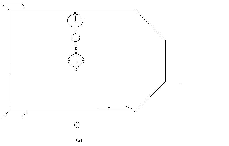

Referring to fig 1
I want to synchronise two clocks.
I have a spaceship traveling at v in the direction of the arrow. In the ship I have two identical clocks one at point A (clock1) and on a point D(clock 2). I also have a light source at point B. Length AB = length BD
I have observers at points E, F, G and H. E and F are at rest with the space ship. G and H are not at rest.
A flash of light is set of by the light source and if it hits both clock simultaneously then they are synchronised. As the light from the light source is traveling perpendicular to the direction of travel of the spaceship the light will reach both clocks simultaneously and they’ll be synchronised.
I will look at what the observers see later.

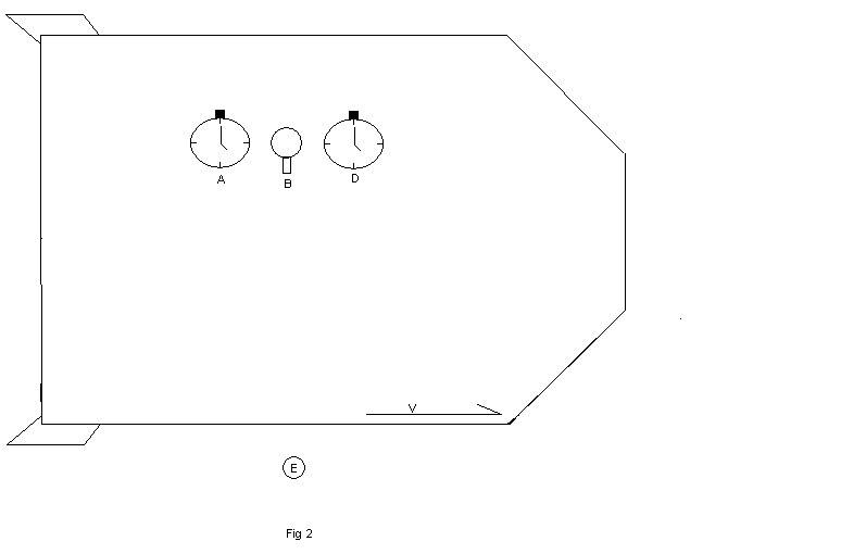

Fig 2 shows how NOT to synchronise clocks as the clocks are equidistant and as they will change position before the flash of light reaches them then the flash will not reach them simultaneously and they will NOT be in sync
Does anyone disagree ?

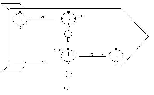

Referring to fig 3
I want to move the clocks, one to the front of the spaceship and one to the back and I want them to still be synchronised from the perspective of the observer at E. The velocity of the spaceship is V.
I move clock 1 from point A to point A hat at velocity V1.
I move clock 2 from point D to point D hat at velocity V2.
The length from point D to the point D hat is equal to the length from point A to point A hat.
There is an observer at E
Depending on the velocities that the clocks are moved at the observer will see the following:
1. If V1 = V and V2 = V
Clock 1 will be stationary, clock2 will be moving at 2V. therefore clock 2 will slow down clock1 will be ahead of clock 2
2. If V1 > 2V and V2 = V
Clock 1 will be moving faster than clock2. Clock 1 will slow down wrt clock2. Clock 2 will be ahead of clock 1
If V1 < V and V2 = V
Same as 1
If V1 = V and V2 < V
Same as 1
If V1 = V and V2 > V
Same as 1
If V1 = X and V2 = V - X
Both clocks moving at same speed therefore they are synchronised
If V1 = c and V2 = c
As both clocks are move at C both will stop and they will be synchronised when they make it to their final destination.

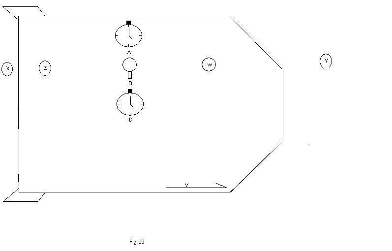

Actually looking at fig 99 when you are synchronising the clocks if you had observers at x, y , z and W and observers x and y assume they are stationary wrt the space ship, all observers would agree that the clocks are synchronised yeh?

Synchronising clocks
Referring to fig 1
You say here that E is "at rest with the space ship", but in subsequent posts you say that E sees the ship in motion, so I guess this is a mistake? You also don't seem to include any points F, G and H in your diagrams.
If E sees the ship moving, he won't see the light traveling perpendicular to the direction of motion...but if he sees the ship moving along the axis from tail to nose, perpendicular to the axis between the clocks, then he'll see the beams of light moving at symmetrical angles so that they both meet the clocks at the same time in his frame, so the clocks will be synchronized in his frame.
Yes, they won't be in sync in the frame of an observer who sees the ship moving forward in this case.

Referring to fig 3
You didn't say whether V1 and V2 are in the ship's frame or E's frame, but below you say that if V1 = V then E sees clock 1 at rest, so I guess they must be in the ship's frame.
Clock 2 won't be moving at 2V in E's frame if it moves at V in the ship's frame and the ship moves at V in E's frame--you have to use the relativistic velocity formula which tells you E will see clock 1 moving at [tex]\frac{2V}{1 + V^2/c^2}[/tex]
Also, if they are both moving the same distance in the ship's frame, then in E's frame clock 1 which is moving towards the tail will reach its destination D-hat before clock 2 which is moving towards the nose reaches its destination A-hat. This is because the tail is moving towards the position clock 1 started at, while the nose is moving away from the position clock 2 started at. Of course they have different velocities in E's frame so this isn't totally obvious, but if they both move at V in the ship's frame then they must reach their destinations simultaneously in the ship's frame, and we know clocks at the nose and tail which are synchronized in the ship's frame will be out-of-sync, with the clock at the tail ahead, so clock 1 must reach the clock at the tail first in E's frame. and clock 1 both have the same time dilation for the same amount of time in the ship's frame, so they must also show the same time as one another when they reach their destinations, so clock 1 must be ahead of clock 2 in E's frame, by exactly the same amount that the clock which is fixed at the tail is ahead of the clock which is fixed at the nose (vL/c^2, where L is the distance between them in the ship's frame).

I quote my initial post
___________________________________________________________
Referring to fig 3
the time will be the distance divided by the velocity as seen by the stationary observer. The clocks are moved equidistant from their initial positions.
Each clock moves the same distance from the inital position say length D it i only the velocities V1 and V2 that alter.
rab99 said:
now from the perspective of E by varying the velocities that the two clocks are positioned at, can the clock at the back of the spaceship (SS) be:
1) ahead of the front clock ?
2) synchronised with the front clock ?
3) behind the front clock ?
OK, then yes, by choosing different values for v1 and v2 any of these can be true in E's frame.
