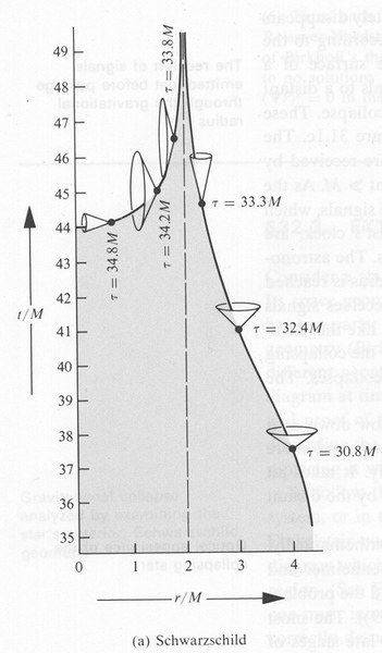

The cones in that famous Finkelstein diagram of 1956, which I think was in Schwarzschild coordinates. :smile:
I am not familiar with "that famous Finkelstein diagram of 1956", unless you are just talking about a standard Eddington-Finkelstein diagram (but then you presumably wouldn't say it was in Schwarzschild coordinates, since Eddington-Finkelstein diagrams are based on Eddington-Finkelstein coordinates). Could you be a little more specific here?

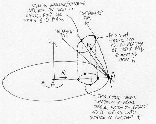

ok … I define my "cylinder" as θ = constant, in the standard Schwarzschild coordinates (t,r,θ,φ), where θ is latitude.
Outside the horizon, if we take a snapshot at any given t, that would look like an actual cone which intersects all the concentric spheres of increasing r at a fixed latitude (see the diagram here), but then if you vary t the cone is unchanging...how is anything falling in here? Are you imagining this cone's surface is made up a continuum of infalling particles?
If so, then since your claim is about the infalling particles "falling out of view" for the observer in the horizon, it seems unnecessarily complicated to talk about a continuum of particles, why not just pick a single infalling particle? I assume your claiming that if we select anyone infalling particle that the observer can see before crossing the horizon, that particle will disappear from view for him sometime after he crosses it?

If you're talking about things like "half-angles" here, presumably you're picturing something...could you please try to draw it? Your verbal explanations really aren't helping much.

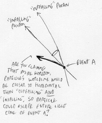

For any particular particle on the "cylinder", falling faster than the observer (in Schwarzschild coordinates), it is inside the cone up to a certain time, then it is outside it.
Are you claiming that the worldline of a particular particle can be such that it intersects the edge of the past light cone of some earlier event on the worldline of the observer, but then it doesn't intersect anywhere on the edge of the past light cone of some later event on the worldline of the observer? That seems geometrically impossible to me. Again, a diagram would be useful.

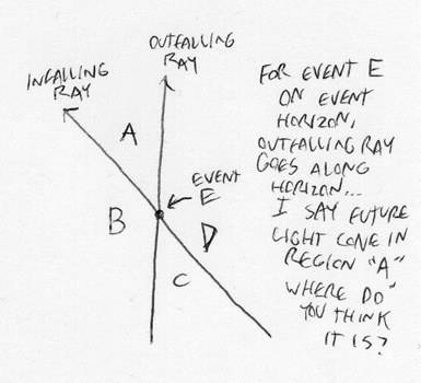

But the fact that he's going "faster" than photons is just an artifact of the coordinate system, where the t in dr/dt is no longer timelike. I don't see how it would have real physical implications like photons from an object that was previously in his past light cone being unable to "catch up with him" after a certain point. And if this physical implication is correct, it should show up in any coordinate system, no? Do you think it would show up in Eddington-Finkelstein coordinates, even though in these coordinates photons on the "underside" of the future light cone of an event on the worldline of an infalling particle always move faster than the particle, while photons on the "upper side" of the future light cone move slower than the particle?
Speaking of coordinate artifacts, I think it's worth pointing out Schwarzschild coordinates look kind of ugly inside the horizon because they make the path of every object appear time-reversed, with the earliest event on their worldline inside the horizon being the collision with the singularity, and the worldline getting closer to the horizon at later values of t, with the distance from the horizon approaching zero as t approaches infinity...see the diagram on p. 848 of https://www.amazon.com/dp/0716703440/?tag=pfamazon01-20 for example. And if you have that book, perhaps you could draw a similar diagram to illustrate what you mean about photons from a particle that could previously be seen by the infalling observer being unable to "catch up" with any points on the worldline the infalling observer after a certain point. Though again, I would much prefer to see an Eddington-Finkelstein type diagram, which has nice features like the fact that photons emitted on the "underside" of the light cone always move on perfect diagonals, and the fact that it doesn't time-reverse worldlines inside the horizon like Schwarzschild coordinates do (also, I've found Eddington-Finkelstein diagrams which trace the complete worldlines of photons emitted from some event on the worldline of an infalling observer, but I can't find analogous diagrams in Schwarzschild coordinates, although the one on p. 848 does show the immediate direction of the photons after being emitted from an event).
One last thing I'd note is that even if we were talking about faster-than-light "tachyons" in ordinary flat SR spacetime using Minkowski coordinates, as far as I can tell, if some object was in the past light cone of an earlier event on the worldline of the tachyon, it would continue to be in the past light cone of all later events on the worldline of that tachyon. So even at this basic level, I don't see how the fact that something is moving faster than light in a given coordinate system would imply that any object would ever "disappear from view".

I don't really follow the details of the math here, but these equations are in Schwarzschild coordinates rather than Eddington-Finkelstein coordinates, yes? And Schwarzschild coordinates are badly-behaved at the horizon--both massive particles and photons take an infinite time to reach the horizon in Schwarzschild coordinates, so naturally they must both approach the same coordinate velocity of zero as the time coordinate approaches infinity. And inside the horizon Schwarzschild coordinates are also fairly counterintuitive, since as I mentioned before they reverse the order of events, with the particles emerging from the singularity first and their proper time decreasing with increasing t, so that they get closer and closer to the horizon from the inside as t approaches infinity as well. There's a helpful diagram of the worldline of an infalling object in Schwarzschild coordinates on p. 848 of Gravitation which I've scanned and included as an attachment. You can see that even within the horizon, the object's worldline stays within the future light cone of any event on the worldline.

No, you're wrong here, the diagram matches all other diagrams of Eddington-Finkelstein coordinates I have seen.
ok … your first diagram is from the University of Winnipeg, and I've already commented on it … your second diagram is from the University of Syracuse NY, copied from Geroch's book, and it only shows "outfalling" photons, not infalling ones, so that doesn't help either of us (except that the slope on crossing the horizon, at U, looks like 45º to me) …
and your third diagram is from MTW's Gravitation, but it is described as "edited" … is the original diagram the same?
(And your fourth diagram, in Schwarzschild coordinates, scanned directly from p.848 of MTW, although it doesn't show a series of photons, it does show the particle going faster than infalling light, doesn't it? :smile:)

Does this mean you think that inside the horizon, the worldline of a particle can actually "escape" the future light cone of an event along it, since in Eddington-Finkelstein coordinates both the "infalling" and "outfalling" worldlines from an event lie above the horizontal, but you seem to be saying the particle's worldline would be closer to horizontal than the infalling worldline? See my attempt at a diagram below.

JesseM said:
But do you agree that if we look at some event A inside the horizon, then the "infalling" photon worldline and the "outfalling" photon worldline that emanate from A form opposite sides of the future light cone from A?
No … I've always found the light-cone concept extremely confusing :frown:
but it seems to me that "in a locally inertial coordinate system constructed out of freefalling rulers and clocks", the "outfalling" photon should go along the past light-cone, not the future one.
How that gets described in Schwarzschild coordinates, or in EF coordinates, I'm not sure … the two half-cones being one inside the other? :confused:
(In your Winnipeg/East Tennessee diagram, for example, it seems to me that the future light-cone must come out of the page into the θ dimension, and never get anywhere near the outfalling photon.
The circle shown in the diagram is, obviously, continuous … but what continuity can there be from an infalling to an outfalling photon? :confused:)​
Does this mean you think that inside the horizon, the worldline of a particle can actually "escape" the future light cone of an event along it, … ?
No … your diagram does accurately depict what I'm saying … but I don't accept that the cone you have drawn is a future light-cone. :smile:
I maintain that the infalling particle can only follow the same paths as infalling photons … but it goes faster.
And that there are no "horizontal" photons, and so infalling photons cannot be on the same half-cone as outfalling ones. :smile:
What makes you say that? Of course a single photon worldline going through an event must lie on both the past and future light cones, I would say the "outfalling" photon is on the right side of the future light cone, and the left side of the past light cone.
The diagram only shows the R dimension and the t dimension, so obviously it must only show geodesics that lie within a surface of constant θ. The circle shown in the diagram represents events which can be reached by rays that emanate from the same event but don't necessarily lie in the surface of constant θ. I've attached another crude diagram to try to show what I mean.
I've also attached a second diagram to try to understand where you imagine the future light cone would be. To make things simple, I imagine we're looking at an event E right on the event horizon, in Eddington-Finkelstein coordinates--in this case, as you can see by looking at the Eddington-Finkelstein diagram I showed earlier, the "infalling" ray will lie on a 45-degree angle as always, while the "outfalling" ray will lie right along the event horizon. I say the set of events in the future light cone of E would lie in region "A" in my diagram, in the 45-degree region between the infalling ray and the outfalling ray...if you disagree, where would you put the future light cone of E? In region "B" perhaps?
hmm … yeah … what I said about the past light-cone is rubbish, isn't it? :frown:
What I was thinking was this …
The radially infalling photon has a "complementary" oufalling photon which is also radial … in other words, the two tangents are collinear. Similary, by the Equivalence Principle, every non-radial infalling photon must have a "complementary" oufalling photon with collinear tangent.
However, using either Schwarzschild or EF coordinates, at each point inside the horizon, the photons are restricted to a cone, and so it seems to me that there must be two "complementary" cones … and I don't understand how they fit together!
In particular, how do we get continuously from the radially infalling direction to the radially outfalling one?
Outside the horizon, there's no problem … we can just go round in a complete half-circle. But inside the horizon, the surface of the cone blocks the way. Go continuously from the axis to the surface … and then what? … bounce off it? … that's not going to look like those nice circles in your Winnipeg EF diagram, is it? :cry:

I've also attached a second diagram … an event E right on the event horizon, in Eddington-Finkelstein coordinates … where would you put the future light cone of E?
hmm … in Schwarzschild coordinates, I would say the future light-cone of E fills out the whole 180º inward hemisphere … further in, at F say, the future light-cone gets narrower. I don't understand where the complementary light-cone fits in.
To specifically answer your question, I say that it's a one-space-plus-one-time-dimensional diagram, and I don't understand exactly where the future light-cone fits in, but I do say that the off-radial part of the cone goes below the 45º line, and, wherever it is, I don't understand how it can veer round through the positions shown in the Winnipeg diagram. :confused:

What do you mean by "the two tangents are collinear"? The infalling photon from an event on the diagram always lies on a 45-degree angle, while the outfalling photon through the same event always lies at some other angle.
I don't understand how you're defining "infalling" and "outfalling" photons if they don't lie on a surface of constant θ which contains the event the photons emanate from (and I assume by 'non-radial infalling photon' you mean that they don't lie on such a surface). Only on this purely radial surface does one of the two photon worldlines that intersects the surface look like a straight 45-degree line, which I thought is how you were distinguishing the "infalling" photon from the non-straight "outfalling" one.
Did you disagree with the first of the two diagrams in my previous post? It shows a circle of points which all lie on photon worldlines emanating from an event A, and if you take the two worldlines that lead to points on the circle that lie on the cross-section θ = 0 (the points whose 'shadows' lie right on the radial axes), one of them is the diagonal 'infalling' line and one is the curved 'outfalling' line. Can you not go in a continuous half-circle from one to the other?
Blocks the way of what? Seriously, I have no idea what picture you're trying to visualize here. It would really help if you'd post your own diagrams. And if you don't have a scanner or a drawing program to do this (there are plenty of decent drawing programs which you can download for free), at least comment on my diagrams, telling me whether there's something in them you disagree with! In my first diagram, there is nothing preventing you from finding a continuous series of photon worldlines bridging the radial infalling worldline and the radial outfalling one, is there?
Go continuously from what axis to what surface? I thought we were talking about going continuously from one light worldline to another light worldline (infalling to outfalling) via intermediate light worldlines, all of which naturally lie on the surface of the light cone. You really don't do a very good job of communicating your ideas clearly!
But I tried to explain how it can veer around through those positions in my first diagram from the previous post. What about that diagram is unclear to you? And to be clear, when you say the off-radial part of the cone goes below the 45 degree line, are you saying that region B in my second diagram would lie within the future light cone of E, not region A?
Also, do you agree that the diagram from the MTW book Gravitation which I posted shows the same thing as the Winnipeg diagram, with the off-radial part of the cone being above the 45 degree lines? You questioned this diagram because it was described as "edited", but I looked back at the book and the image on the webpage appears identical to the one in the book, maybe they just called it "edited" because they didn't include all of the surrounding page. I can do my own scan of this diagram in the book and post it if you're skeptical. I also have a copy of the Geroch book, and he also shows the light cones as lying above the 45 degree lines, I can post his diagrams as well if you wish. If I do, will you then acknowledge that you have been visualizing light cones and particle worldlines in Eddington-Finkelstein coordinates incorrectly?
