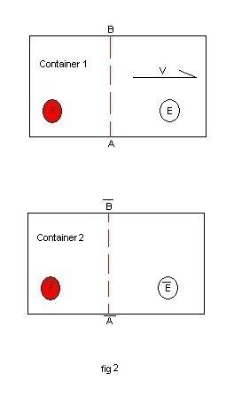

Referring to fig 2
Points A,B,E and F are all within a shipping container (Container 1) and the points are at rest wrt the shipping container.
There is a laser at A that fires a thin beam of photons (say a single photon) to point B where there is a very thin detector.
There is an observer at point E and a red light at point F.
If the photons are not hitting the detector then the red light at F turns on.
Still referring to fig 2 there is a second shipping container identical to the container 1, call this container Container 2.
Again points A hat, B hat, E hat and F hat are all within the second shipping container and are at rest wrt that shipping container.
Again there is a laser at A hat that fires an extremely thin beam of photons, a single photon stream, to point B hat where there is a very thin detector.
There is an observer at point E hat and a red light at point F hat.
If the photons from A hat are not hitting the detector at B hat then the red light at F hat turns on.
The observer at E can see the light in Container 2 and visa versa.
Initially the 2 sea containers are at rest wrt each other and the lasers are aligned so that the photons in each container strike point B and B hat respectively.
Container 1 is then accelerated up to a constant velocity D. At all times the observer in container 1 can see the light in container 2 and visa versa
Referring to fig 3
This is a magnified view of container 1 which is now moving at a constant velocity. As can be seen the photons in container 1 will take a finite time to travel from point A to the opposite side of the container. In that time the as container 1 is moving at some velocity D the container would have moved to a new position in space by the time the photons strike the opposite side of the container. Therefore the photons will NOT strike point B but will instead strike some other point to the left or right of B. Ill assume they strike a point to the left of B, point G.
As the photons are not striking point B the light at F will turn on and the observers at points E and E hat will see that light.
The observer at E will know he is moving as the light has come on.
The observer at E hat will know the observer at E is moving wrt E hat as E hat will see the light.
As the light at F hat has not turned on the observer at E hat and E will know he (the observer at E hat) is not moving.
Anyone disagree ?

The laser beam will always move parallel to the orientation of the laser apparatus in the laser apparatus' rest frame. So, it will always hit the same point on the wall of the shipping container--in a frame where the shipping container is moving, the laser beam will appear to slant so that photons remain directly above the laser apparatus even as the laser apparatus moves sideways.
I believe the container will distort in shape (length contraction and curvature at the top as viewed from the side) due to its velocity.

I don't understand what's different about these two paragraphs. In any case, if the laser apparatus is pointed at point B, the photons will always strike point B regardless of the container's (inertial) motion. I don't know what to tell you about the "why" question, it's just a feature of the laws of electromagnetism that a directed beam from some apparatus, like a laser or a flashlight, always moves in the same direction in the apparatus' rest frame, and therefore must appear slanted in the frame of an observer who sees the apparatus in motion. The laws of electromagnetism are after all Lorentz-symmetric, which means you can mathematically prove that they must work the same in all the inertial frames related by the Lorentz transformation. All the other known laws of fundamental physics are Lorentz-symmetric too, so your quest to try to find a way to detect absolute motion is destined to fail, unless you discover some new laws of physics which aren't Lorentz-symmetric.

The laser behaves just like the bullets, with the photons not falling behind the car in the frame where the car is moving, and the laser going straight out in the car's rest frame.

The bullets travel in a straight line due to inertia. The laser travels in a straight line due to Maxwell. They both travel in a straight line.
The direction/angle of a straight line of travel is trivially frame-variant.

You're not moving with respect to yourself. As has been pointed out several times, you will not detect any slanting in your own frame. Someone else can measure the degree of slant and use that as a measure of your speed with respect to their frame.

Perpendicular according to you.
In the moving frame are the photons exiting perpendicular to the ends of the laser ?
No.
I assume they must be or the person at rest wrt the frame would measure an angel.
No.
If no angel can be measured then the entire laser must have rotated yeh?
No.
