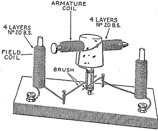

heathphysics
The motor that I've built is the one below its a working motor and spins fast, but for the assignment we have to slow it down to as much as we can. Does anyone have any ideas as to how I can make this motor spin slowly. I've tried using less wire but it doesn't work. Please Help! Note: for the piece of cork, I've used wiring tape instead.
