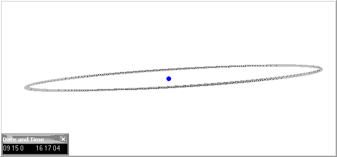

I am toying with the idea of creating a general orbital simulator. Possibly lacking the proper terminology, here is a basic description of my goal, make that wild dream.
Step 1. Working in 2 dimensions, user enters the mass of 1 to N object, their initial position, their initial velocity, and a time calculation interval. For each time interval, the simulator calculates the forces that each body applies to each other body, the summed vector of that force, applies it to the initial velocity, and determine the position at the end of the time interval. It then shows the position of each body. Repeat.
Step 2. Add niceties like lines showing where each body has been for some number of iterations so we can better see the activity.
Some future step, make it three dimensional.

This approach will work fine with one object. The object will move in a straight line because there no forces act on it. This approach will not work very well with two or more objects. The approach you outlined is called the Euler method for solving an initial value problem (i.e., a system whose complete system state is known at some point and whose evolution is described by a set of ordinary differential equations). The Euler method is very simple to implement but unfortunately does an incredibly lousy job except for the simplest of systems.
Fortunately, a lot of numerical integration techniques exist that do yield good accuracy. They are all more complex than the Euler method, but many are only a bit more complex. A couple of nice balances between complexity and accuracy are the velocity verlet technique, which is widely favored in chemistry simulations, and the fourth-order Runge-Kutta (RK4) technique, which is widely favored in orbital simulations. A quick google on velocity verlet and Runge-Kutta will yield a lot of information.

This is a direct consequence of using the Euler method. The Euler method displays this problem even with two bodies and even without any eccentricity.

The method you described is the basic verlet method. As you noted, it is better than Euler. An even better approach and still very simple to understand is Heun's method.

The cited simulator updates the velocity and then updates the position using the updated velocity. This is not a very good integrator. A simple improvement is to update the position using the average of the velocity before and velocity after the velocity update. This simple improvement is Heun's method, a second-order Runge-Kutta integrator. Heun's method is considerably better than the midpoint method, another second-order Runge-Kutta integrator.

I'm also trying to make an n-body orbital simulator, its going quite well - I've recently upgraded from euler to fourth order runga-kutta.
I've been using Cartesian coordinates for all of my work so far, and for the actual calculations i plan to continue - but i need to be able to use keplerian orbital elements instead of state vectors for initial conditions. I was wondering if anyone out there had experience or direction on how to convert between orbital elements and state vectors besides drowning myself in geometry. Thanks!
Regardless of what everyone is telling you, your method will work fine. Just be prepared to use very small time steps if you are using Euler's method.
Besides inaccuracies that can occur due to the approximate nature of the solution, the near-collision "explosion" can be solved by simply defining the force piecewise. Calculate the distance between each pair of bodies (this must be done anyway) and see if it's less than some minimum value (this can be as simple or as complicated as you like). Then decide whether or not you want to "do" the force there, and act accordingly. Otherwise, you could use a similar method to use conservation of momentum to have them collide (elastically or inelastically) like billiard balls. Or have them lump together and run until all masses have lumped together.
There's a lot of potential for fun and good programming in what you're talking about.Good graphics can be done in Java, C, C++, C#, Visual Basic, etc. For 3-D, you may even look into DirectX or OpenGL.
The programming won't be hard, but there are some things you can do to make it easy on yourself. Look for libraries with functions / objects you can use. I recommend taking the opportunity to explore OO approaches, if you're not already familiar with these. You can make objects for vectors and massy particles and this will greatly ease the notation. Have fun with it.
